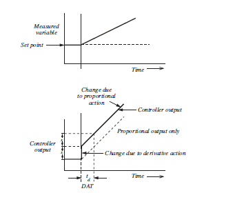

FIGURE 5 shows a proportional plus derivative controller that has aproportional band of 20% and a derivative action time of 0.1 minutes.
Construct the shape of the output waveform for the triangular input
waveform shown, if the input rises and falls at the rate of 4 units
per minute.
Unsure
I have calculated the gain by using the PB to calculate a figure of 5 for the gain. Would I be right in saying that for and input change of 1 units there would be an output change of 5 units? The integral action time is 6 seconds so after 12 seconds the output will have increased to 10 units, is this right? Am no sure how to sketch this as a waveform? Any help would be greatly appreciated.

Your calculation of the proportional gain is correct. it has a gain of 5, however this is independant of time or what happened before
you say it is a PD controller (proportional + derivative), but then in your attempt you are talking about integrals?
Your derivative portion will simply multiply the action by the rate of change.
Sorry that is a typo it should say derivative action time.

The important thing to note is that the proportional and derivative paths are in parallel. that means that they simply sum together, and the output of one does not effect the output of the other. So you compute the output of the proportional path (which as you said is the input with a gain of 5) plus the output of the derivative path (which the action multiplied by the rate of change) does that make sense?
if you are having trouble, try sketching the proportional and derivative paths independent of each other, then add them
I have these diagrams in the learning material (see attached) but i wouldn't class this as a waveform.
So a input change of 1 unit would produce a output change of 5 units, then every 6 seconds this output would increase by 5 due to the derivative action?? Then after 30 seconds the input would begin to decrease and the reverse would happen?

no
the change has no effect on the proportional gain, it is independent of time. in your case the proportional output will allways be the current input values multiplied by 5.

so in our example if you line that increases at a rate of 5 units/sec starting at 0,
the derivative output will always be 2.5 (because the rate of change will stay the same)
the proportion output will be 0 at t=0, 10 at t=1, 20 at t=2, etc. does that make sense?\
now try your problem again
Right so I get that proportional output will be,
input output
0 0
1 5
2 10
so over the minute step change the input will rise 2 units and then fall 2 units? Equating to a proportional output of 0 initially followed by 5, 10, 5, 0?
Sorry I'm not following the derivative part. I understand that the derivative action of 0.1 multiplied by the rate of change will give you the derivative output, is the rate of change for my example 4 units / 60 seconds?

the derivative poprtion of the controller simply take the derivative of the input (rate of change) and multiplies it by the action (whihc is just a multiplier value). let's say the derivative action was 1, just to make it simple. before the input starts to rise, the rate of change is 0 units/second. So the output due to the derivative is zero. Then when the input starts to rise, the derivative is 4 units/sec (this is given). so simply multiply the 4 units/sec by the derivative action to find the output due to the derivative controller.

Ok so when you say multiply the rate of input change i.e.4 units/minute in my example by the derivative action do you mean the derivative action time? So 4 units/minute x 01. minutes to give an initial output increase of 0.4 units? Then a proportional increase of 5 units per 1 unit of input?
Do I need to show the controller output reducing? After the initial 30sec input increase of 2 units the input will start to decrease back to 0.

Yes. after the input starts to ramp down, the derivative will be negative and the gain will start to decrease.
