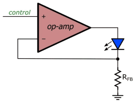

I have a proportional-only controller LED driver circuit -
I need to fine-tune its ##K_P## to 10 for a significant input of -0.2 to 0.2 V in the steady state. In that case, should I use a potentiometer with 10:1 setting? The LED (actuator) can drive voltages between 0 to 4V, so I need to add a resistor bias offset voltage to the controller as well. Can someone help me in these? I know that I need to utilize the Thevenin circuit, so should I just make a resistor bias from my positive rail supply to ground? Cam someone help me out?

You should regulate the current through a LED, not the voltage across it.
The circuit you give is for a voltage controlled current sink, which is good.
The 4 V appears across Rfb, the current sense resistor, not the LED.
What is the power supply voltage? Is it sufficient for 4V + Vled ?
Do you know what maximum current will be needed by the LED?
Can the op-amp source that current or will you need something like an emitter follower?
Kp = 10; Ten what? mA/volt or volt/volt ?
Why not fix the maximum voltage across Rfb to 0.4 volt ?
Then design the required control voltage level shift.

Kp is in terms of volt/volt, which is thus across Rfb. The Op-Amp is enough to source the current required. In order to set Kp at 10, I've used another resistor from the LED, which is approximately 9 times that of the feedback resistor. This does give me a output voltage of 10 times that of the input voltage through the output terminal of the Op-Amp, but this works for only positive voltage inputs. Negative voltage inputs seem to saturate the output. Can you suggest an alternative in this case?

Are you still sure you want to regulate LED voltage rather than control current ?

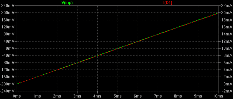

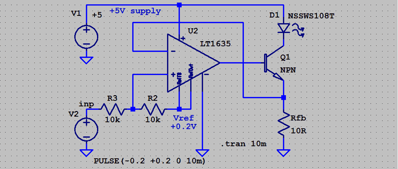

Yes, I was doing it wrongly. I created a separate controller for the LED driver, and it's working fine now. Only, I need to get an output of 0-4V from the controller part (without the LED, it functions as a non-inverting amplifier), instead of a -2 V to 2 V output from -0.2 to 0.2V input. Can you give me a hint regarding how to setup the voltage divider with 3 resistors? I've been trying out configurations and have done some shifting, but can't obtain the 0-4 level-shifted output.
It is real bad practice to use a power supply rail as a voltage reference, mainly because it will add noise to the signal. Changing the power supply will require a recalibration.
The offset will require an accurate voltage or a current reference. You should be aware that there are a number of op-amps that have an 0.2 V buffered reference voltage, and can operate without a negative supply. The LM10 was the first example. There are many more now.
