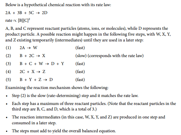

g) This is the part I am having trouble on. Can someone please explain how I should go about writing the reaction mechanism.
h) This part can be done once part g) is complete.Thanks.
What did you try so far? You can write down some possible mechanisms ("first step: X+Y -> Z, second step: ...") and see if they fit to the reaction rates you got. If not, change them.

Not a reaction mechanism but some reaction mechanisms. There are surely several possible. (This is just formal kinetics; if you had a proper reaction with identified molecules you would probably be able to eliminate some as chemically unreasonable.)
As you say the reaction will not happen via collision of three or more molecules. One possibility is that some of them are in (unfavourable) equilibrium with a complex, And that is the Real reactive species that goes on to react fast. So you could get started by thinking of possibilities based on that. Or then perhaps two molecules of reactant do rarely collide and react, and everything following is fast.

Here are three reaction mechanisms I came up with:
#1:
(1) A+B --> W (fast)
(2) C+W --> D+ X (fast)
(3) B + 2C --> Y (slow)
(4) C+ X + Y --> D +E (fast)
#2:
(1) A--> W (fast)
(2) C+W --> D + X (fast)
(4) C+ X --> Z (fast)
(5) B + Y + Z --> D +E (fast)
#3:
(1) A --> W (fast)
(2) 2C + W --> D +X (fast)
(4) B + X + Y --> D + E (fast) Are any of these correct/appropriate? Thanks.
All those reactions would lead to a fast production of D and deplete B and/or C before the slow reaction can happen, especially in test 2 with a lot of A present. You would get D, maybe something else, but not much E.
Also all of them is written involved productive trimolecular collisions, which are so rare that they never are part of a reaction mechanism you have at least to propose a multistep process that uses the same result. I think there are simpler schemes that give you the required result.
Also when you proposal scheme you should derive your rate equation (d) for it. Wwe would see what your k is it in terms of the various rate constants of your mechanism.

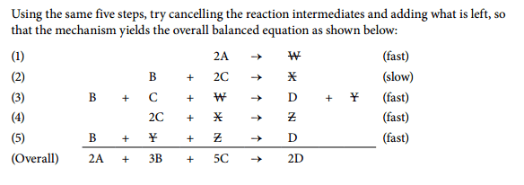

Here is the section about reaction mechanisms from my lesson:
I used the lesson as guidance, and it seems that it uses a lot of trimolecular collisions... :/
They are not the most likely reactions, but they work. You could change "B+Y+Z->D" to "B+Y->G, G+Z->D" for example, without a difference for the overall reaction.

Seeing your question about three weeks ago I immediately thought of two or three mechanisms that would work which I have since forgotten. So to give you an idea possible one is:
dimerisation of C to form a small amount of dimer, fast so that it is essentially in equilibrium with monomer
2C ↔ C2 so we have essentially [C2] = (k1/k-1) [C]2
followed by slow (rate-determining) reaction of the dimer with B
C2 + B → C2B , rate = k2 [C2][ B]
After which if followed by fast steps it makes no difference to the rate equation what exactly that these are, as the rate will be
rate = (k2k1/k-1) [ B][C]2 whatever these are.
You could make some reasonable suggestions like
2 C2B → C4B2 (fast)
followed by a fast reaction to form a complex that also rapidly dissociates to final products.
C4B2 + A → C4B2A → 2D + E
Anything reasonable in these post-rate-determining stages is as good as anything else, you have no experimental evidence to distinguish different mechanisms. If you have included trimolecular reactions at this stage, you can surely re-elaborate them making extra stages so that you have only bimolecular or monomolecular ones. I expect you could find other possible mechanisms that fit the kinetics.
