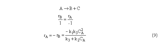

My question is, why do they go about finding the rate law for B from the original reaction, instead of by steps. The way I thought to do this was to find ##r_{A}## from the elementary steps, exactly the same way they found ##r_{A^{*}}##.
##r_{1A} = -k_{1}C_{A}^2##
##r_{2A} = -k_{2}C_{A}C_{A^*}##
##r_{A} = r_{1A} + r_{2A}##
However, there is some complication with ##r_{A2}##. Since the reaction is ##A^* + A \rightarrow A + A##, How can I do the reaction rate of A assuming irreversible? I don't know if it should be ##r_{A2} = -k_{2}C_{A}C_{A^*}## or ##r_{A2} = -k_{2}C_{A}C_{A^*} + k_{2}C_{A}^2##

Ok, so I fixed the part about the ordering of ##r_{1A}## vs. ##r_{A1}##, that was just a memory lapse. Apparently, the way to figure out the mechanism to a reaction is to memorize the table I have in my 2nd post. My problem is not memorizing the table. My issue is how they went on to find ##r_{A}## from their proposed mechanism. The proposed mechanism is
(1) ##A + A \xrightarrow {k_{1}} A^{*} + A## ##\hspace{0.5 in} r_{1A^{*}} = k_{1}C_{A}^2##
(2) ##A^{*} + A \xrightarrow {k_{2}} A + A## ##\hspace{0.5 in} r_{2A^{*}} = -k_{2}C_{A^{*}}C_{A}##
(3) ##A^{*} \xrightarrow {k_{3}} B + C ## ##\hspace{0.875 in} r_{3A^{*}} = -k_{3}C_{A^{*}}##
So then they sum ##r_{A^{*}} = r_{1A^{*}} + r_{2A^{*}} + r_{3A^{*}}##
Using the pseudo-steady state hypothesis, they say ##r_{A^{*}} = 0## and find an expression for ##C_{A^{*}}##. However, why is this step not repeated in finding ##r_{A}##? When they find ##r_{A}##, they simply say ##r_{B} = k_{3}C_{A^{*}}##, then substitute in ##C_{A^{*}}## found from ##r_{A^{*}}##, then using the original reaction ##A \rightarrow B + C##, they say ##r_{A} = -r_{B}##.
My proposal is to do exactly what they did for ##r_{A^{*}}##. I have an issue with reaction (1). How would you write ##r_{1A}## for that?
##r_{1A} =- k_{1} C_{A}^2##, or maybe it would be ##r_{1A} = -k_{1}C_{A}^2 + k_{1}C_{A}C_{A^{*}}##, or even perhaps something else? How do you write an elementary rate law with respect to a given species when the species is both a product and reactant, and the reaction is not reversible?
This issue is not relevant with respect to ##A^{*}## because that intermediate species is always either solely a reactant or solely a product, never both simultaneously in any of the 3 reaction steps.
OK, re my comment about + and -, sum and difference, I see they have put signs into your equations 1, 2, 3 and so your sum is an algebraic sum, which I think is slightly unusual presentation but OK now I know. In words the rate of change of [A*] is its rate of formation minus its rate of disappearance via two processes.
For your question check back to what they say about the PSSH. Assume that [A*] is small compared with [A]. Then
([A] + [B ]) is constant is just conservation of mass for that reaction, and rA = - rB is just saying the same thing (a molecule of A is converted into one of B).
B is created in a unimolecular elementary irreversible reaction from A*, step (3) and Eq. 3 is the physical consequence of this first-order process.
Why not do for rA what they did for rA* and equate it to 0? You notice if we do that we have no kinetics and no problem, that it would be saying A is not undergoing any reaction? A and B are at the ends of the scheme, A* is in the middle. Think of it like say a despatcher who sends a large amount from A on to B but in his own warehouse has only a small amount at any time. Because it is small the change of absolute amounts are small, it is A and B that are changing a lot.
