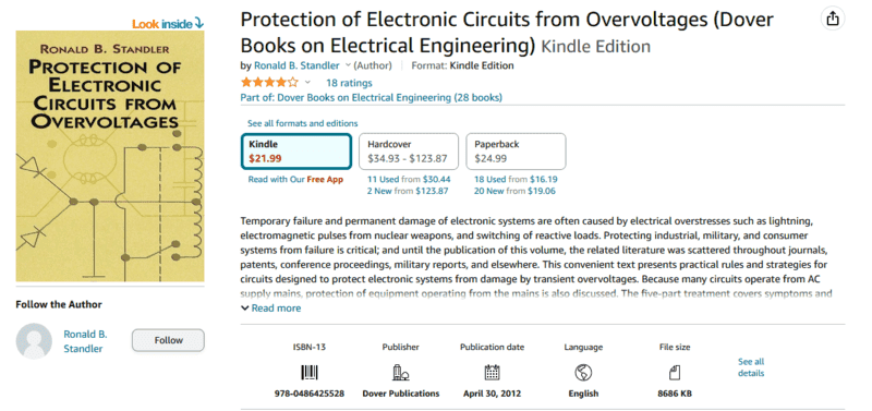

Standler is the standard reference book for learning more about this subject (use the Amazon "Look Inside" feature to see the table of contents):
https://www.amazon.com/dp/B00A736SOM/?tag=pfamazon01-20
Likes winSOW32

Very useful and interesting, I will take a look at it. What you say is true, here everyone protects their machines by putting metal meshes on the displays, aluminum sheets on the pcb (especially the controllers) and some connect the power supply cord to ground.
