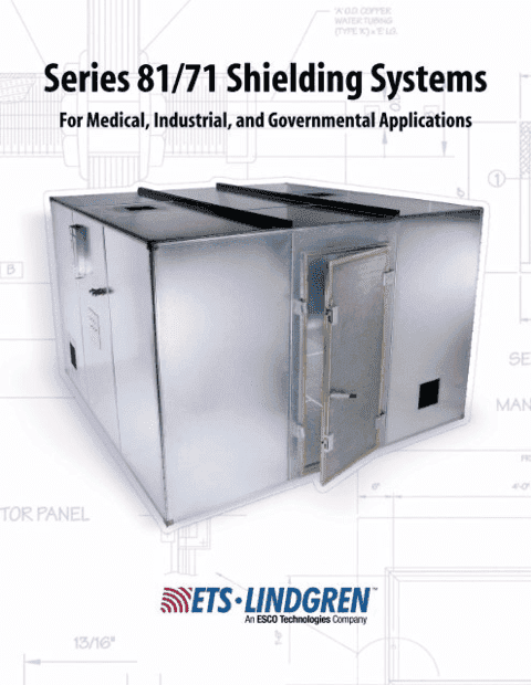

In addition to using a shielded room to protect equipment from the strong ElectroMagnetic Interference (EMI), you need to put filters and transient suppression devices on the cables that connect the equipment inside the room to power and data cables outside of the room. It does little good to use a shielded room if the cables are not filtered and protected too.
https://www.yumpu.com/en/document/view/19537459/series-81-71-shielding-systems-ets-lindgren
