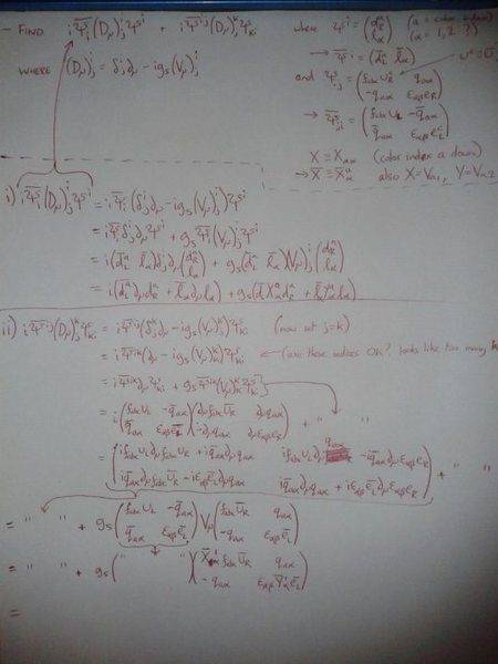

OK I have attached what I've got for $$ i \bar{\psi}_i ({\not \! D})^i_j \psi^i + i \bar{\psi}^{ij} ({\not \! D})_j^k \psi_{ki}$$ but I'm not well practiced with this stuff and the last bit is a step or two away from being complete - I got confused on the last line I've shown here. Also I wasn't sure if the way I've correctly written out [itex]\overline{\psi}_{i}, \overline{\psi}_{ij}[/itex] given [itex]\psi_{i}, \psi_{ij} [/itex] (I've shown what I did for each in the top right corner)?
OK, I realize I had a mistake where ##f_{abc}## should be ##\epsilon_{abc}## in ##\psi_{ij}##, so
$$\begin{split}
& \psi^i = \begin{pmatrix} d_R^a \\ \ell_\alpha\end{pmatrix}, \\
& \psi_{ij} = \begin{pmatrix} \epsilon_{abc} u_R^c & q_{a\alpha} \\
-q_{a\alpha} & \epsilon_{\alpha\beta} e_R \end{pmatrix}.
\end{split}$$
You are on the right track and will get there eventually, but let me try to quickly get the terms that give the ##X## and ##Y## couplings. These are
$$ i \bar{\psi}_i ({\not \! D})^i_j \psi^i + i \bar{\psi}^{ij} ({\not \! D})_j^k \psi_{ki}\rightarrow i \bar{\psi}_\alpha ({\not \! V})^\alpha_a \psi^a + i \bar{\psi}^{ia} ({\not \! V})_a^\alpha \psi_{\alpha i} + \text{h.c.}$$
The first term gives
$$ i \bar{\psi}_\alpha ({\not \! V})^\alpha_a \psi^a = i \bar{\ell}_\alpha ({\not \! V})^\alpha_a d^a_R,~~~(1)$$
while the 2nd gives
$$\begin{split}
i \bar{\psi}^{ia} ({\not \! V})_a^\alpha \psi_{\alpha i} &= i \bar{\psi}^{ba} ({\not \! V})_a^\alpha \psi_{\alpha b} + i \bar{\psi}^{\beta a} ({\not \! V})_a^\alpha \psi_{\alpha \beta} \\
&= i \epsilon^{bac} \bar{u}_{Rc} ({\not \! V})_a^\alpha (-q_{\alpha b}) + i \bar{q}^{\beta a} ({\not \! V})_a^\alpha \epsilon_{\alpha \beta} e_R.~~~(2)\end{split}$$
Since ##X_a = V_a^1##, the terms with ##X## are
$$ i \bar{e}_L ({\not \! X})_a d^a_R + i \epsilon^{bac} \bar{u}_{Rc} ({\not \! X})_a(-u_{L b}) + i \bar{d}_L^a ({\not \! X})_a e_R
+\text{h.c.}.$$
See if this makes sense to you. I want to check a couple of things to make sure the 2nd term makes physical sense.

First of all for (1) I'm not sure why you got [itex]i \bar{\ell}_\alpha ({\not \! V})^\alpha_a d^a_R[/itex] (ie. quark and lepton) when I had terms that only had quark or only had lepton?
Also I keep seeing fields with that superscript c all over the place ([itex]u^{c}_{R}, e^{c}_{R}[/itex], the attached diagram etc.), what does that indicate? Charge conjugation?
And for (2), on the first line I don't understand what happened there - the first term on the right hand side is the same as what appears on the left hand side, just with [itex]b[/itex] replacing [itex]i[/itex], what's the difference caused by simply changing the label? Clearly there is one because a similar-looking term appears on the right hand side too, this time with [itex]\beta[/itex] replacing [itex]i[/itex]. I can see that [itex]b, \beta[/itex] are both indices on the [itex]\epsilon[/itex]'s but I don't understand what happened there.
