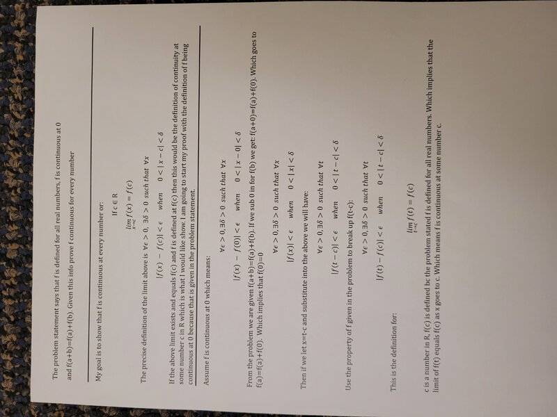

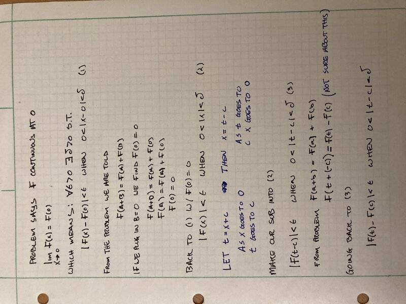

The problem tells us f is continuous at 0 and that if f(a+b) = f(a)+f(b) then prove f is continuous at every number.
The solution in the book used a different approach but I am trying to start with the precise definition of continuity and prove from there.
For all epsilon >0 there exists delta >0 ST
|f(x)-f(c)|<epsilon. When. 0<|x-c|<delta
I attached my attemp at the solution. I am trying to start with continuity at 0 and end up with limit of f(x) equals f(c) as x goes to c.
Could someone take a look at the attached image and let me know if I am on the right track or where I went astray
Sorry picture is rotated I tried but can’t get it to come in right.
Although your description of your proof is straightforward, the organization of your proof is confusing. It's hard to see if it is correct.
It's not clear that it is following your description: "I am trying to start with continuity at 0 and end up with limit of f(x) equals f(c) as x goes to c."
1) You should start in a way that briefly makes it clear which point continuity is being established (i.e. define ##c\in\mathbb{R}##). Also define ##\epsilon\gt 0##.
2) Use the continuity of ##f()## at 0 to get ##\delta##:
3) Use that ##\delta## to prove continuity at ##c##:

@FactChecker Thanks for the reply. I agree I let out details and was unclear. I tried to be more detailed and clear about my structure in image below. Is this better.
That looks good to me. I might quibble about some "wordsmithing" things, but the logic and flow seems fine.
