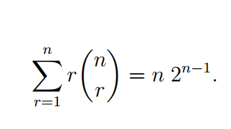

Prove the following
I literally have no idea where to start or what to do.

Hi there. :)
The binomial theorem states that \(\displaystyle (x+y)^n = \sum_{k=0}^{n}\binom{n}{k}x^ky^{n-k}\). What happens if you let $x=1$ and $y=1$?
Jameson said:
Hi there. :)
Doesn't really help me to be honest.
Hi Niamh,
Let $S = \sum_{r = 1}^n r\binom{n}{r}$. Then
$$S = 0\binom{n}{0} + 1\binom{n}{1} + 2\binom{n}{2} + \cdots + (n-1)\binom{n}{n-1} + n\binom{n}{n}$$
$$S = n\binom{n}{n} + (n-1)\binom{n}{n-1} + \cdots + 1\binom{n}{1} + 0\binom{n}{0}$$
Using the fact that $\binom{n}{r} = \binom{n}{n-r}$ for $0 \le r \le n$, add the two equations column-wise, then use the binomial theorem, to obtain $2S = n2^n$. Dividing by $2$ yields the result.
Here's another easy proof using calculus:
$$(x+1)^n=\sum_{r=0}^n{{n}\choose{r}}x^r$$
Take derivatives:
$$n(x+1)^{n-1}=\sum_{r=1}^nr{{n}\choose{r}}x^{r-1}$$
Eavaluate at x=1:
$$n2^{n-1}=\sum_{r=1}^nr{{n}\choose{r}}=\sum_{r=0}^nr{{n}\choose{r}}$$
Hi Niamh,
My post and the two below show the main connection you need, that is how to connect the summation sign to something resembling $2^n$. At first glance this is a quite strange equation and the key is the binomial theorem as I mentioned. If you let $x=1$ and $y=1$ you get:
\(\displaystyle (x+y)^n =(1+1)^n=2^n= \sum_{k=0}^{n}\binom{n}{k}x^ky^{n-k}=\sum_{k=0}^{n}\binom{n}{k}1^k1^{n-k}=\sum_{k=0}^{n}\binom{n}{k}\)
Using this trick we have now connected $2^n$ to something with this summation. That was the idea behind my post. :)
What have you tried?
