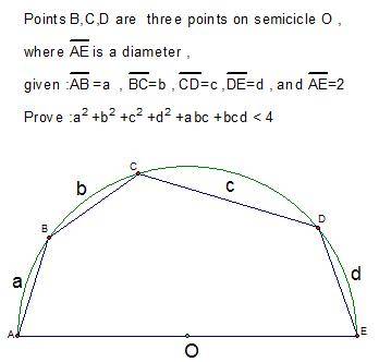

AE is a diameter of a semicicle O,points B,C,D are three points on this semicicle
Given :AB=a ,BC=b ,CD=c ,DE=d ,and AE=2
please prove :
$a^2+b^2+c^2+d^2+abc+bcd < 4$

Because of the symmetry between the pairs $(a,d)$ and $(b,c)$, we may reduce the problem to one of two variables:
Prove:
\(\displaystyle a^2+b^2+ab^2<2\)
where $a$ and $b$ are found from the following diagram:
Using the Law of Cosines, we find:
\(\displaystyle a^2=2-2\cos(\alpha)\)
\(\displaystyle b^2=2-2\cos(\beta)\)
Since $\alpha$ and $\beta$ are complementary, we now have the objective function in one variable (after dividing through by 2):
\(\displaystyle f(\alpha)=2-\left(\cos(\alpha)+\sin(\alpha) \right)+\sqrt{2-2\cos(\alpha)}\left(1-\sin(\alpha) \right)<1\)
Differentiating with respect to $\alpha$ and equating to zero, we may find the critical value(s) (using a numeric root-finding technique) on the relevant interval:
\(\displaystyle \alpha\approx1.06048703739259044748\)
Thus, checking the end-points of the interval, we find:
\(\displaystyle f(0)=1\)
\(\displaystyle f(1.06048703739259044748)\approx0.767829392509715815674068\)
\(\displaystyle f\left(\frac{\pi}{2} \right)=1\)
Thus, we may conclude that for \(\displaystyle 0<\alpha<\frac{\pi}{2}\) we must have:
\(\displaystyle f(\alpha)<1\)
which is what we needed to show.
please prove :
https://www.physicsforums.com/attachments/968
connecting AC, and CE ,from law of cosine:
$AC^2=a^2+b^2-2ab\, cos B=a^2+b^2+2ab\,cos \angle AEC>a^2+b^2+abc(1)$
likewise :
$CE^2>c^2+d^2+bcd(2)$
now using pythagorean theorem (1)+(2) we have :
$AC^2+CE^2=AE^2=4>a^2+b^2+c^2+d^2+abc+bcd$
