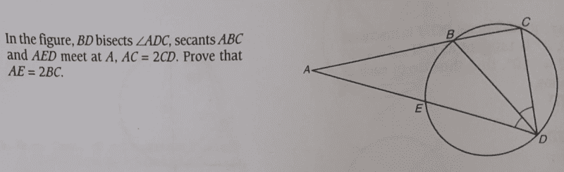

See attached
Geometry
This is the textbook question. I do not have the solution. I am pretty stuck on this one:cry:

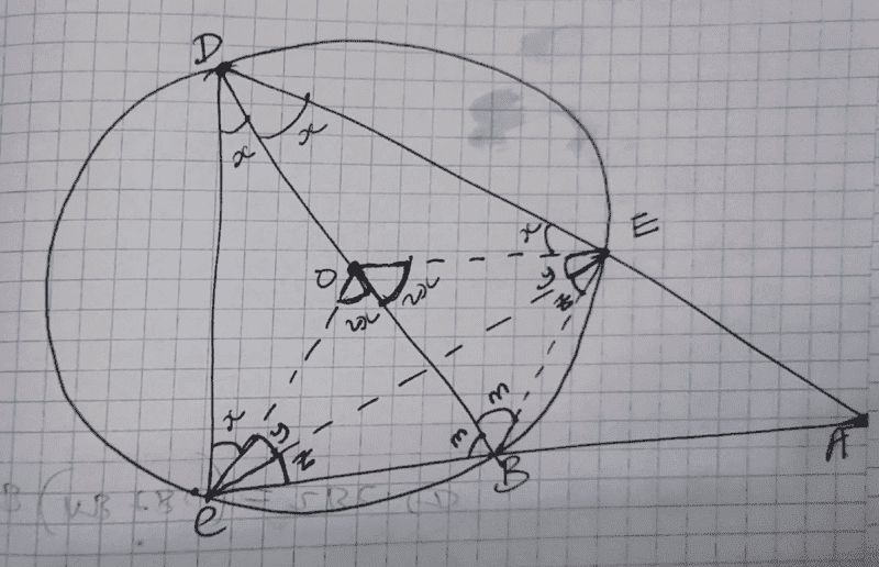

My attempt on this...find my rough sketch here;
From my analysis;
##x+x+m+m=180^0## angles opposite each other on a cyclic quadrilateral... I have point ##O## as the centre of the circle.
##x+y+z+x+y+z=180^0##
##⇒2(x+y+z)=180^0, x+y+z=90^0## therefore ##∠DEB= ∠AEB = 90^0##
Also i know that;
##AB⋅AC= AE⋅AD##
As
BC=BE
We should prove
\triangle DCA \sim \triangle BEA
I do not seem to get it...from my analysis;
I let the radius ##OD=OB=OE=OC=1##unit.
Therefore; ##BD=2##units.
##∠ODC=∠ODE=30^0## each.
##∠(x+y+z)= 90^0, ∠y=∠z=30^0##each, ##∠m=60^0##
##∠OCBE## is a Rhombus of side ##1## unit.
##\sin 30^0= \dfrac{BC}{BD}##
##0.5= \dfrac{BC}{2}⇒BC=1##unit.
##∠AEB= 90^0##
##∠BAE=30^0## therefore ##\sin 30^0= \dfrac{BE}{AB}##
##0.5= \dfrac{1}{AB}⇒AB=2##unit.
We know from pythagoras theorem that ##AE^2+BE^2=AB^2##
##AE=\sqrt{3}## which does not conform to what we want. Am i missing something here?
...Maybe it ought to be ##AB= 2BC##

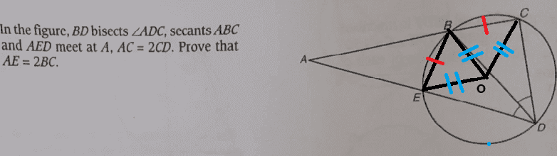

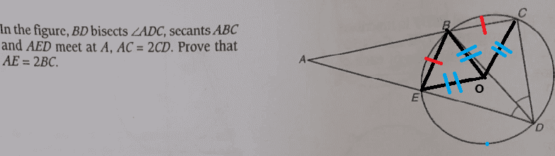

We see
\angle ABE=\angle CDE
by drawing OE,OB and OC where O is center of the circle, which is not on BD,with attention to
\angle BOE = \angle BOC = 2 \angle BDE
OB=OE=OC
anuttarasammyak said:
We see
by drawing OE,OB and OC where O is center of the circle, which is not on BD.
I have no dispute on this...my working has factored in all that...
We see
OB=OE=OCView attachment 315334
Are you of the opinion that ##AE= 2BC##? As is indicated?

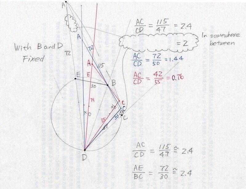

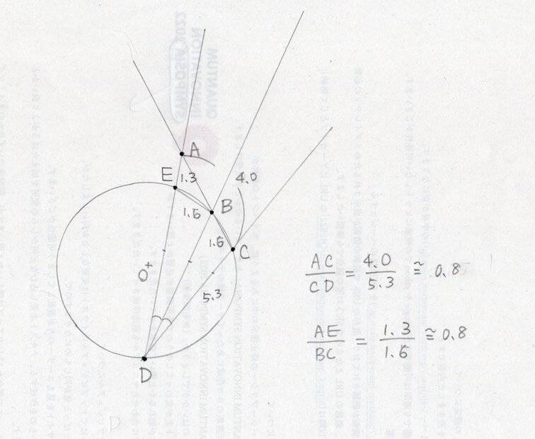

Yes. More in general
\frac{AC}{CD}=\frac{AE}{EB}
for not only 2 but any ratio value.

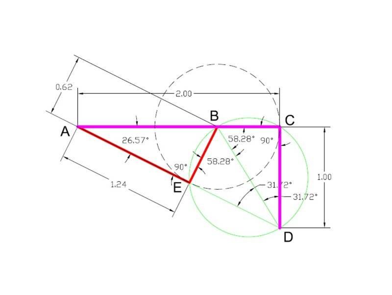

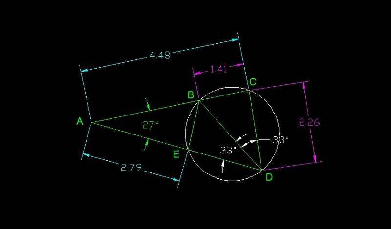

chwala said:
Phew man! How were you able to determine the angles?
AutoCAD does it for me.
I have been trying to make it work with different angles, but so far it does not comply with the identities.
I will keep trying tomorrow.

chwala said:
...still a problem there...##AE## is NOT twice ##BC##
Exactly!
That is why more work is needed.

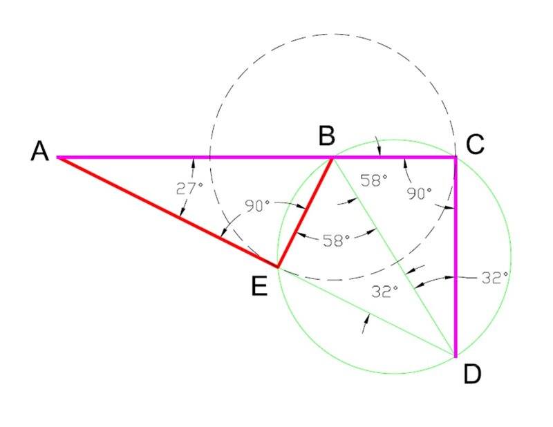

If angle ACD is a 90, then angle EAB must be the arctan of 0.5 (as AC=2CD).
However, that does not work either.

Some thoughts on a way to measure the lengths in general configuration.
O: unit circle with B,E,C.D on it. In cartesian coordinates
##B(1,0),E(cos \theta, sin\theta),C(cos\theta,-sin\theta),D(cos\phi,sin\phi)##
Equation of line BC: ##y=\frac{sin\theta}{1-\cos\theta}(x-1)##
Equation of lne DE: ## y-\sin\theta = \frac{\sin\theta-\sin\phi}{\cos\theta-\cos\phi}(x-\sin\theta)##
Thus
A(\frac{\sin\theta(1-\frac{\sin\theta-\sin\phi}{\cos\theta-\cos\phi})+\frac{\sin\theta}{1-\cos\theta}}{\frac{sin\theta}{1-\cos\theta}-\frac{\sin\theta-\sin\phi}{\cos\theta-\cos\phi}}, \frac{\sin\theta}{1-\cos\theta} \frac{\sin\theta(1-\frac{\sin\theta-\sin\phi}{\cos\theta-\cos\phi})+\frac{\sin\theta}{1-\cos\theta}}{\frac{sin\theta}{1-\cos\theta}-\frac{\sin\theta-\sin\phi}{\cos\theta-\cos\phi}} - \frac{\sin\theta}{1-\cos\theta} )
By them we can get formula of side length of triangles in general configuration.

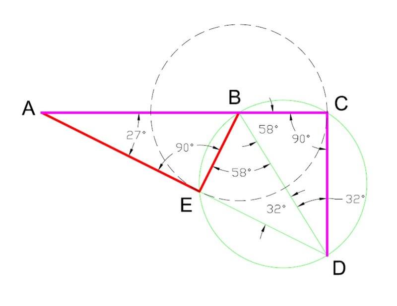

I take it as an approximation because tan 64 degrees = 2.05030384158... ##\neq## 2.
It is only the resolution with which the software represents the angles; I could increase it later to show that the angle's values are exactly what should be to satisfy the 1:2 proportion of the sides of the triangles.
That last drawing shows two 1:2 proportion sides in red for one triangle and two sides in magenta for the other triangle.
Rather than starting with angles, I followed the description of the problem: two secants and one bisector.
Then, I draw the green circle using three points of reference (B, C and D), not knowing where the center would located at.
The green and the dashed circles both pass by point E naturally.
The only liberty I took was assuming the 90 degree angle.
For any combination, the bisector passes by the center of the circle, which makes the top lines symmetrical (note dashed line circle).
Thanks for the explanation. I am not sure and interested in whether we can always choose 90 degree angle configuration, i.e. BD is diameter of the circle, for not only 2 but any given ratio of the sides by adjusting circumference angles. It may be.
chwala said:
You may have a valid point...but remember this is a textbook question that may not warrant use of software in a class setting. In other words, how would students show the proof as required?

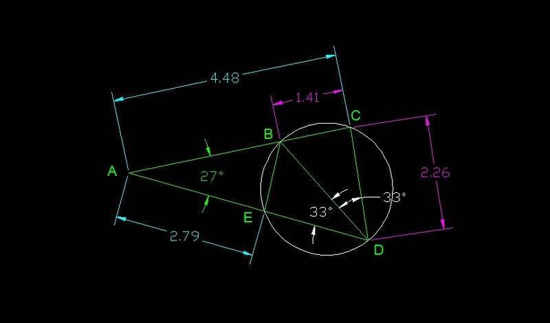

I don't know how to prove it, reason for which I have used a drawing at scale.
This time, I started from a 2-unit horizontal line followed by a 1-unit vertical line (ACD magenta lines), and ended up with a 1:2 proportion red lines.
Therefore, at least two of the formed triangles must be proprtional (1:2 sides plus one similar angle).
@anuttarasammyak , attached is the same drawing, with improved resolution for the angles and measurements of the sides of the triangles.
Likes anuttarasammyak

Is ##BE## equal to ##BC## as indicated?if so, is my analysis correct as shown on post ##33##?
Arc BE and Arc BC have same angle of circumference or central angle. Their length are equal thus BE=BC.
I apologize saying "I do not need BE=BC" and "congruence and similarity" in error.

Nice ...what's your ultimate goal/intention on having different drawings on the problem?
No specific goal or intention.
Just trying to understand the problem, which results interesting to me.
The first drawing was the result of beginning with assumed angles: it did not work.
The second drawing was the result of beginning with the information given in the text of the problem: it worked.
The third drawing is exactly as the second one, only showing the value of the resulting angles with a resolution of 0.00, so @anuttarasammyak could see that those values correspond to the 1:2 proportion of the sides of the triangles.
chwala said:
... are the measurements of ##AE## and## BC## tending towards the envisaged value? Or drifting away...cheers.
AE (1.24 units) is twice as long as BE (0.62 units).
The discontinuos-line circle shows us that the lenghts of BE and BC are exactly the same.
  • #43
I understand that the graphic way is not the way for any student to prove what the problem requires to be proved, as you stated before.
The problem is that I don't know enough math or trigonometry to prove it mathematically.
I hope that my drawings help you gentlemen to find a way to do so, as they prove that the problem is properly stated and that is solvable.
Your diagram looks accurate and convincing! Just one question, i thought for similar Triangles we need to have two pair of corresponding angles which is not the case in your diagram...
you have ##90^0, 26.57^0, 63.43^0## on one triangle and ##90^0, 31.72^0,58.28^0 ## on the other triangle.
Otherwise, if we were to go with your diagram, then the assertion ##AE=2BC## is correct.
  • #46
Please find below my rough hand drawing of the problem. It happens to be the case of
AC/CD = AE/BC = about 0.8. :wink: O is outside DE.
May I understand that you say the ratio 2 is the special case that O must be on BD ?
  • #47
nice @anuttarasammyak ... looks like after all... ##AE≠2BC##...rather;
From your analysis; ##AE=\dfrac{4}{5}BC##
  • #48
May I chip in.
Although the diagram makes BD look like it might be a diameter, there is no reason to assume it is (as I think has already been noted).
Consequently, we can’t assume things like ∠EBD = ∠CBD or that ∠BCD = 90º.
There is nothing wrong with the problem statement.
If you are familiar with certain theorems, the solution is straightforward.
The intersecting secants theorem tells us that:
AB•AC = AE•AD.
The angle bisector theorem tells us that:
AD•BC= CD•AB
We are given AC = 2CD.
Proving that AE=2BC requires only simple algebra using the above equations.

  • #49
The essence of the problem is
AC/CD=AE/BC
coming from same arc lengths and similarity of triangles.
I draw another case which happens to have the ratio of about 2.4 and a procedure to find the case of ratio 2. With fixed B and D, O keeps out of BD.
