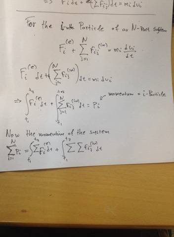

1.Problem statement
Prove the average external force of a system of particles N starting from rest and ending at rest is zero.
If the system moves periodically prove the av. external force is zero in a period
I don't quite understand what i am asked .Since i don't have a definition for a average force of a system of particles. Yet i tried to derive the eq for momentum of a system.So this is the momentum of the system i found. Now i know that going from rest to rest change of momentum must be zero . But i have internal and external forces. So don't know how to proceed
There is someething with internal forces you need to exploit here. has to do with one of the Newton laws...:
what is the effect of an internal force on the motion of the system ?
Its zero the rest of the math is ok? SO the double sum is zero.
Can't read the small writing. What I hinted at is action = - reaction so the internal forces can't influence the center of mass of the system
