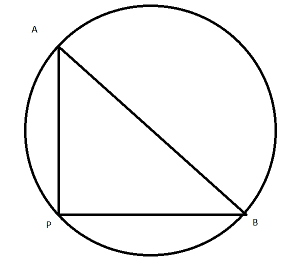

Here's a very bad drawing (I forgot to insert the origin in, but let's just say it's there) (and let's say that the angle between BP and BA is x)
Is this sufficient?
|AB|^2 = |AP|^2 + |PB|^2
2r = d
|AP| = dsin(x)
|PB| = dcos(x)
|AB|^2 = d^2
d^2 = d^2 (cos(x)^2 + sin(x)^2)
d^2 = d^2

You can't start with the Pythagorean theorem because you don't know that is a right triangle. That is what you are supposed to prove.
2r = d
|AP| = dsin(x)
|PB| = dcos(x)
|AB|^2 = d^2
d^2 = d^2
You aren't trying to prove ##d^2 = d^2##.
But if it satisfies the pythagorean theorem then that must mean it's a right triangle right?
At the risk of repeating myself: You DON'T KNOW it satisfies the Pythagorean theorem because you don't know ##x## is a right angle.

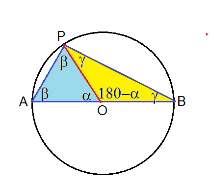

If you do what LCKurtz (Post #15) suggested and draw the line OP, it cuts the triangle into two isosceles ones. The angle APB is β+γ. What is its value?
I see why they are isosceles now, then
2γ = α
2γ + 2β = 180
γ + β = 90
