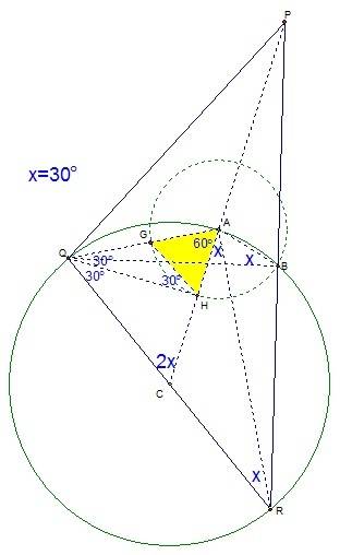

from the diagram it is clear :
[FONT=MathJax_Math-Web]P[FONT=MathJax_Main-Web],[FONT=MathJax_Math-Web]A[FONT=MathJax_Main-Web],[FONT=MathJax_Math-Web]C are collinear.

explanation of previous diagram:
$\triangle GAH , \triangle QAC $ both are equilateral triangles
$\therefore \angle GAH=\angle AQC=60^o$
in $\triangle PQC : \angle Q=90^o, \angle PCQ=2x=60^o$
$\therefore \angle QPC=30^o$
also in $\triangle PQA$ :$\angle PAQ=180^o-30^o-30^o=120^o$
and we have :$\angle QAC +\angle PAQ=60^o+120^o=180^o$
so points $P,A,C $ are collinear

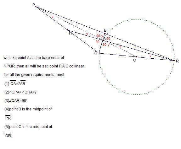

But, I don't think the given info suffices to deem the point $A$ as the barycenter of the triangle $PQR$; also, I don't quite follow how $\angle CAR=y$?:confused: I mean, of course $\angle CAR=y$, but, don't we have to prove that first before claiming such is the case?
anemone said:
Thank you Albert for your solution!
point A on circle C
AC=CR=QC, for
$\angle QAR=90^o$
yes,you are right ,point A does not have to be the barycenter of triangle $PQR$ , but always lie on segment PC
(the prove and diagram is simiar to post #8)
in special case it will switch to its barycenter

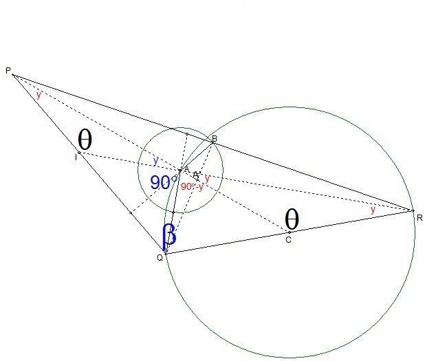

$\triangle PQC $ and $\triangle RQI$
$\theta=\beta+y$
$\angle CAR=\angle ARC= \angle QPA=\angle PAI=y$
for $\triangle PAI $ is similar to $\triangle RAC$
in this diagram point $A'$ is the barycenter of $\triangle PQR$
and point $A$ lies on segment PC ,is what we want
$\therefore$ point $P,A,C $ collinear

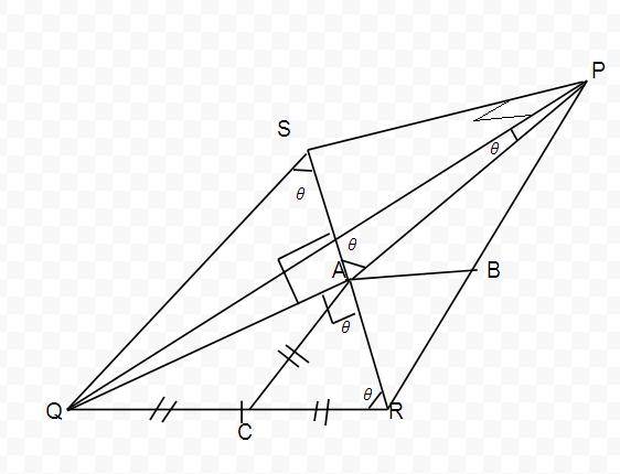

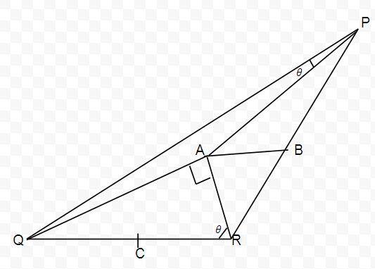

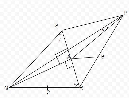

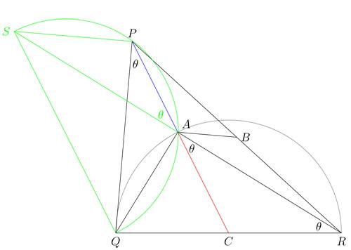

Here is the solution of other that I want to share:
Extend $RA$ such that $RA=AS$. Let $\angle QRA=\angle QPA=\theta$.
Observe that $QA$ is the perpendicular bisector of $RS$. Hence $QR=QS$ and $QRS$ is an isoceles triangle. Thus, $\angle QSA=\theta$. But then $\angle QSA=\angle QPA=\theta$. This implies that $Q,\,A,\,P,\,S$ all lie on a circle. In turn, we conclude that $\angle QAS=\angle QPS=90^{\circ}$.
Since $A$ is the midpoint of $RS$ (by construction) and $B$ is the midpoint of $PR$ (given), it follows that $AB$ is parallel to $SP$ and $SP=2AB=QA$. Thus, $QAPS$ is an isosceles trapezium and $SQ$ is parallel to $AP$.
We hence get $\angle SAP=\angle QPA=\angle QRA=\angle CAR$.
The last equality follows from the fact that $\angle QAR=90^{\circ}$, and $C$ is the midpoint of $QR$ so that $CA=CR=CQ$ for the right-angled triangle $QAR$.
It follows that $P,\,A,\,C$ are collinear.

That is a beautiful proof! I drew this diagram to help me understand it:
[sp]
The aim is to show that the blue and red line segments are collinear. The green elements are those constructed for the proof. At the point $A$, the angle between $AP$ and $AS$ is $\theta$, the angle between $AS$ and $AQ$ is $90^\circ$, and the angle between $AQ$ and $AC$ is $90^\circ - \theta$. Their sum is $180^\circ$, as required. [/sp]
