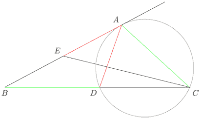

In the triangle \(\displaystyle ABC\) a point \(\displaystyle D\) lies on the edge \(\displaystyle BC\), \(\displaystyle E\) - on the edge \(\displaystyle AB\). Aditionally, \(\displaystyle BD=AC\), \(\displaystyle AD=AE\) and \(\displaystyle AB^2=AC\cdot BC\). Prove that \(\displaystyle \sphericalangle BAD = \sphericalangle CEA\).
I have to do this task on Maths class on Monday and I need any tips or something because I don't know how to start it.

I won't give you the answer, but see if you can show that (1) the line $AB$ is tangent to the circle through $A$, $C$ and $D$; (2) the triangles $BAD$, $CEA$ are congruent.

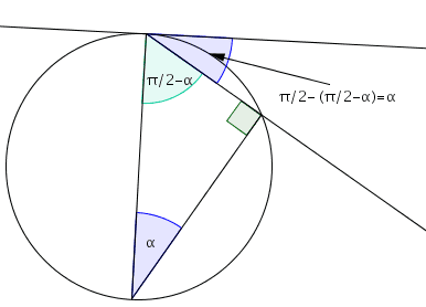

Proof: the line $AB$ is tangent to the circle through $A$, $C$ and $D$
Knowing that \(\displaystyle BD=AC\), \(\displaystyle AD=AE\) and \(\displaystyle AB^2=AC\cdot BC\), we get \(\displaystyle \frac{AB}{AC}=\frac{BC}{AB}\) and then \(\displaystyle \frac{AB}{BD}=\frac{BC}{AB}\). Thus, the triangles \(\displaystyle ABD\) and \(\displaystyle CBA\) are similar. So \(\displaystyle \sphericalangle BDA=\sphericalangle CAB\) and \(\displaystyle \sphericalangle BAD=\sphericalangle ACB\). Additionally, \(\displaystyle \frac{AC}{AB}=\frac{AD}{BD}\) (because the triangles \(\displaystyle ABD\) and \(\displaystyle CBA\) are similar). So \(\displaystyle \sphericalangle BAC=\sphericalangle BDA\), and what's more \(\displaystyle \sphericalangle ADC=\sphericalangle CA...\) (there is no letter on line AB after A).
As a result, the line AB is tangent to the circle through $A$, $C$ and $D$ because of the theorem of which is illustrated on the photo.
Is it correct? Is there any better proof?
