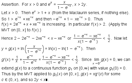

Here's another solution which just uses a careful application of the mean value theorem.
