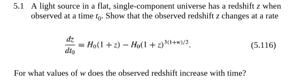

I am trying to prove that for a single component flat universe
$$\frac{dz}{dt_0} = H_0(1 + z) - H_0(1 + z)^{\frac{3 + 3w}{2}}$$
For a single component flat universe,
##q = \frac{2}{3 + 3w}##
##a(t) = (t/t_0)^q##
##t_0 = qH_0^{-1}##
##1 + z = (t_0/t_e)^q##
Now here is my approach,
$$\frac{dz}{dt_0} = qt_0^{q-1}t_e^{-q} = q (t_0/t_e)^qt_0^{-1}$$
$$\frac{dz}{dt_0} = q ( 1 + z) q^{-1}H_0 = H_0 (1 + z)$$
Can someone point it out what am I missing. Like I am trying over 3 days now. Either I suck at math or there's something that I am missing
Edit: This identity can be derived from above identities but I wanted to write
$$t_e = \frac{t_0}{(1 + z)^{3(1+ w)/2}} = \frac{2}{3(1 + w)H_0} \frac{1}{(1+z)^{3(1+ w)/2}}$$

You are missing something: ##t_e## is a function of ##t_0##, i.e., ##t_e = t_e \left( t_0 \right)##. Consequently, when ##z## is differentiated with respect to ##t_0##, because of the quotient (or product) rule, you should get a second term.
Imagine that, over millions of years, you watch a distant galaxy through a telescope. As you watch, you see the galaxy progress in time. But what you see in the eyepiece is the galaxy as it was at the time of emission, i.e., the emission time ##t_e## changes as the observer's time ##t_0## changes.
I have derived the required result using this method, but I doubt that what I have done is what Ryden expects. I will look into this.

Honestly, the question is not very well defined as what is being observed is not well defined. If you consider observing a comoving object, then you need to take the change in ##t_e## with ##t_0## into account. However, if you observe something like a spacelike surface of constant cosmological time (such as the CMB), then clearly ##t_e## would be fixed.

The question asks you to first show the relation and then to find particular values of w. The OP’s issue is related to the first part, not the second.

The idea is to let the observation time ##t_0## progress into the future. I do not like this notation, because, for example, it would mean that the the expression ##a \left( t \right) = \left( t/t_0 \right)^q## (valid for fixed ##t_0##) would have to change to something like ##a \left( t \right) = A t^q##. (Why?) Better to drop the subscipt ##0## from the observation time, i.e., just write the observation time as ##t##. Then, ##a \left( t \right) = \left( t/t_0 \right)^q## for a fixed ##t_0## is valid. The subscipt ##0## can be inserted at the end
Take a comoving galaxy as the light source. Taking into account that ##t_e## is a function of observation time ##t##, find ##dz/dt##. To differentiate ##a \left( t_e \right)##, use the chain rule.

##\frac{dz}{dt_0} = \frac{d}{dt_0}(t_0^q t_e^{-q} - 1)##
So we can write
##\frac{dz}{dt_0} = qt_0^{q-1}t_e^{-q} - qt_0^qt_e^{-q-1} \frac{dt_e}{dt_0}##
So first term is ##H_0(1+z)##
##\frac{dz}{dt_0} = H_0(1+z) - qt_0^qt_e^{-q-1} \frac{dt_e}{dt_0}##
In the other side we have again ##H_0(1+z)##
$$\frac{dz}{dt_0} = H_0(1+z)[1 - t_e^{-1}t_0 \frac{dt_e}{dt_0}]$$
Is it correct up to here ?

Almost, but I think that you are missing a factor of ##t_0## in the second term in the square brrackets on the right.

so we have
So it means that ##dt_e/dt_0 = 1/(1 + z) ## ?
