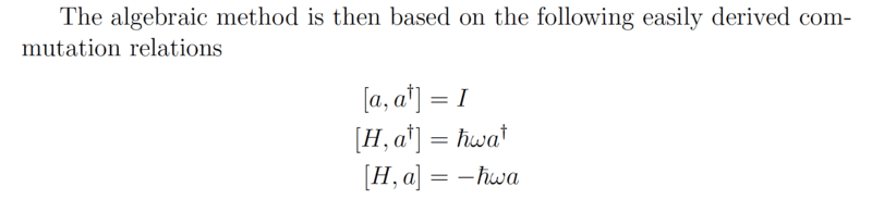

I am going through my class notes and trying to prove the middle commutator relation,

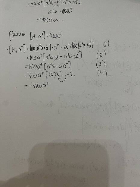

I am ending up with a negative sign in my work. It comes from [a,a] being invoked during the commutation. I obviously need [a,a] to appear instead.
Why am I getting [a,a] instead of [a,a]?

Hint: Calculate ##[H, a^{\dagger} ] |1>## using ##H|n> = (n + 1/2) \hbar \omega |n>## and ##a^{\dagger} |1> = c |2>##. What happens?

Seems to me the step (2) is wrong, you are changing the order of operation there
In step (1) you have ## (a^\dagger a + \frac{1}{2})a^\dagger - a^\dagger(a^\dagger a + \frac{1}{2}) ##
But in step (2) you have ## a^\dagger (a^\dagger a + \frac{1}{2} - a^\dagger a - \frac{1}{2})##
Redo step (1) to (2), keep the order of operators unaltered.
Likes guyvsdcsniper
It seems to me step (1) is wrong. The commutator disappeared…
Too early in the morning, you just expanded the commutator. I would not do this, I would apply commutator rules for ##[AB,C] = A[B,C]+[A,C]B##.
Likes guyvsdcsniper, malawi_glenn and vanhees71
Thanks to all, I have seen the trivial mistake I made. I was able to get the correct answer now.
