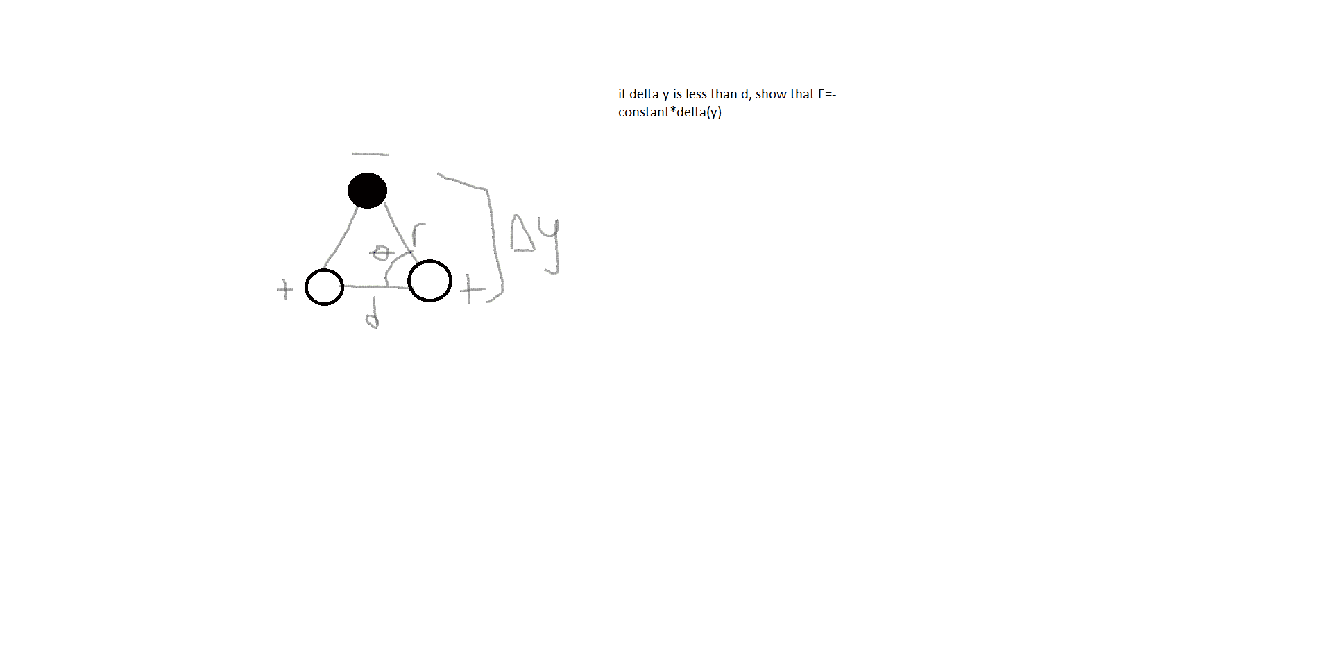

I need to prove that F=-constant*(delta y) if delta y < d
I have no idea how to go about this. Please help!

Look at one of the white balls. There are three forces acting on it: 1) the weight, 2) the tension, and last but not least, 3) the electric force. If the system is stable then the sum of these forces is 0 N.
Can you finish from there or do you need more detail?

well I think weight is mgsin(theta) and tension is Fesin(theta) + mgcos(theta)
But I don't know theta and I don't get what delta y has to do with it

I didn't notice this last night...What force are you trying to find?
Either way you are likely to have to consider at least some of the following...
Consider the charge on the right. The electric force between two point charges is \(\displaystyle F = \frac{k q^2}{d^2}\). The weight of the ball is mg, and you have a tension force,T, acting up and to the left at an angle \(\displaystyle \theta\). Using the usual xy coordinate system we have Newton's 2nd:
\(\displaystyle \sum F_x = -T~cos( \theta ) + \frac{kq^2}{d^2} = 0 \)
\(\displaystyle \sum F_y = T~sin( \theta ) - mg = 0\)
Use the y equation to get an equation for T. Put that T value into the x equation. That will get you an equation for d in terms of \(\displaystyle \theta\). Beyond that I don't know what force you are trying to calculate.
-Dan

I'm not sure. I do know I need to show that the negative charge would bounce up and down as if on a spring.
Show that F = -constant * delta y
This is what I have so far that we did in class. He said we needed to make a substitution somewhere but I don’t understand where
2F=[Kq^2/r^2]2
Fy = [2Kq^2/r^2] sin theta
Sin theta = delta y/r
Sin theta = delta y/(d/2)
