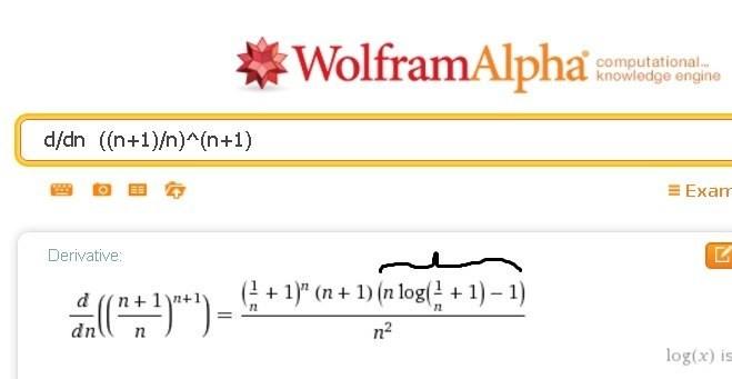

I tried that, but to know if it is indeed monotonic I have to show that the selected expression in the term the picture I attached is always < 1 or > 1.
So to proof of the original problem requires a proof for:
n*(log(n+1)-log(n)) < 1
Right now it looks pretty circular.
