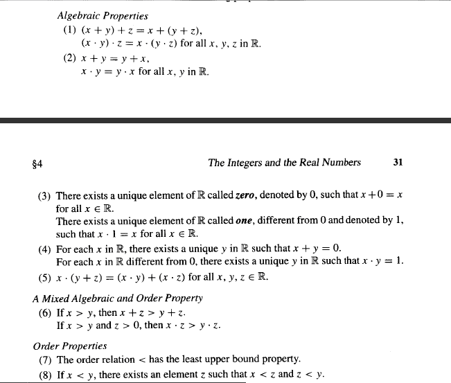

This is a topology book, and it has a list of axioms, 8 total, and says the first 6 form a field, which is reminiscent of vector spaces that I studied in linear algebra, and then the last two axioms showed that the reals had completeness, I think is how they worded it, am I getting the general idea wrong? I can site the book specifically, but this wasn't really related to the question at hand.
6 axioms for a field? It's 10 when I write them down. (four for addition, four for multiplication, and the left and right distributive laws). The definition of "ordered field" has two more, both for the < relation. The final axiom that takes us to the real numbers is the upper bound property.
