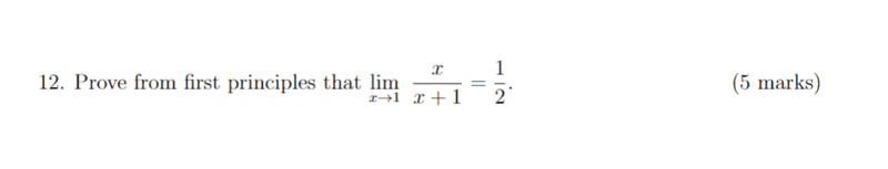

For this problem,

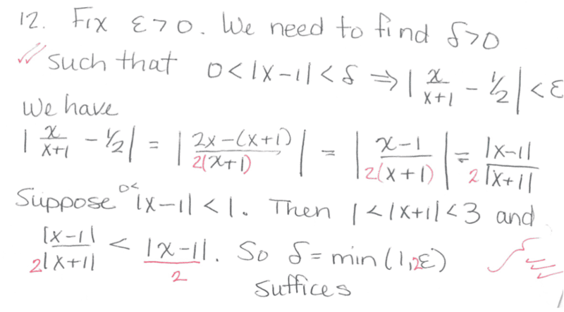

The solution is,
However, I'm confused how ##0 < | x - 1|< 1## (Putting a bound on ##| x- 1|##) implies that ##1 < |x+1| < 3##. Does someone please know how?

[tex]\frac{x}{x+1}=1-\frac{1}{x+1}[/tex]
The problem is reduced to prove
[tex]\lim_{x \rightarrow 1} \frac{1}{x+1} = \frac{1}{2}[/tex] or further
[tex]\lim_{x \rightarrow 1} x = 1[/tex]

We are interested in the neighborhood of ##x=1## so assuming ##0< |x-1|<1## is not a problem. The left inequality is always true, and the right one means
\begin{align*}
|x-1| < 1 \Longleftrightarrow 0<x<2 \Longleftrightarrow 1<x+1<3
\end{align*}
We get therefore
\dfrac{|x-1|}{2|x+1|} < \dfrac{1}{2|x+1|} < \dfrac{1}{2\cdot 1}=\dfrac{1}{2}
But this isn't small enough. We have to narrow down ##|x-1|##. If ##\delta = 2\varepsilon ## and ##|x-1| < \delta ## then
\dfrac{|x-1|}{2|x+1|} < \dfrac{\delta}{2|x+1|}=\dfrac{2\varepsilon }{2|x+1|} < \dfrac{2\varepsilon }{2\cdot 1}=\varepsilon .

What do you mean? The picture you uploaded was ok, except for the corrected factor ##2.##
Do you mean what you typed below your picture? I guess ...
ChiralSuperfields said:
This allows us to remove the absolute values around the x - 1 and 2.
... is the culprit, but I am notoriously bad with absolute values. I always have to scribble a lot to get it right.
My solution was ##0<|x-1|<1 \Longrightarrow 0<x<2 \Longrightarrow 1<x+1<3.## I don't understand why you made it so complicated.
Since ## |x-1| < 1, 0 < x < 2##. Therefore, ##1<x+1< 3##.

It should be pointed out why the assumption ##|x-1| < 1## is made here: The purpose is to find a ##\delta## such that ##x/(x+1)## differs from 1/2 by at most ##\epsilon##. Restricting ##\delta < 1## is not a problem - if you could find a ##\delta \geq 1##, a ##\delta < 1## would clearly also suffice.
The issue if you do not restrict ##\delta## to some value smaller than 2, then ##x+1 = 0## becomes a possibility and ##|x/(x+1)|## is unbounded. Particularly larger than ##\epsilon## around ##x = -1##. So we choose to restrict ##\delta## to avoid this. Then, as mentioned above, we need to further restrict ##\delta## for values of ##\epsilon > 1/2##.
Note that we could have chosen ##\delta < k < 2## instead. This would imply
\frac{|x-1|}{|x+1|} < \frac{k}{2-k}
which is sufficient if ##\epsilon > k/(2(2-k))##. If not, then
\frac{|x-1|}{|x+1|} < \frac{\delta}{2-k}
and choosing ##\delta < (2-k)2\epsilon## works.
