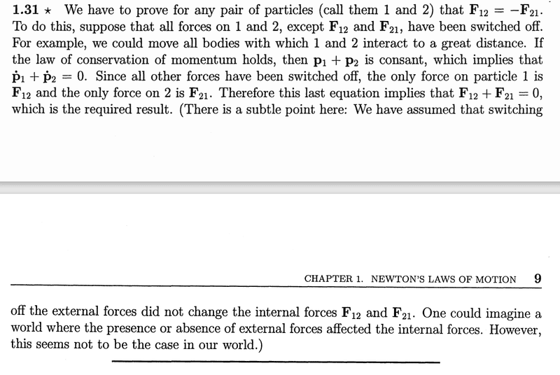

In Section 1.5 we proved that Newton's third law implies the conservation of momentum. Prove the converse, that if the law of conservation of momentum applies to every possible group of particles, then the interparticle forces must obey the third law. [Hint: However many particles your system contains, you can focus your attention on just two of them. (Call them 1 and 2.) The law of conservation of momentum says that if there are no external forces on this pair of particles, then their total momentum must be constant. Use this to prove that F12 = - F21.]
dP/dt = 0 iff Fext = 0
F12 = - F21
I don't quite understand the "subtle point" at the end of the author's solution. Ok, let's imagine for a second that the external forces have an impact on the internal forces. How does that change the mathematical result that the two forces are equal and opposite to each other? Even if, hypothetically, we lived in a world where "the presence or absence of external forces affected internal forces", the magnitude or direction of the forces could potentially change change, but the relation between the internal forces, i.e. Newton's 3rd law, would still hold...
Or am I missing something?
Possibly, but the author's point is that the proof given depends on the assumption that those other forces can be switched off without affecting the two in question.
E.g. consider three particles where F12=-F21+x, F23=-F32+y, F31=-F13-x-y. Momentum is conserved. But if, by some magic, if you take any one particle away then the forces between the remaining two become equal and opposite, so momentum is also conserved for each subsystem.
