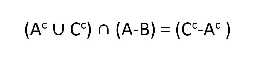

Could someone help me in this by simplifying/Proving the equation using Theorems/ Rules on Operation of Sets (i.e Commutative property, idempotent, assoc, dist. , definition of union , def. intersection , DeMorgan ,etc.).
Letting A, B and C be three sets ..
Prove/Disprove :
Any solution would be much of help. Hoping to get answers .. Do help me :) Thank you!

Greetings TheGreat! Welcome to MHB! (Wave)
Let's start by replacing the subtractions by regular set operations.
That is, replace $A-B$ by $A \cap B^c$, and replace $C^c - A^c$ by $C^c \cap (A^c)^c = C^c \cap A$.
It makes it a bit easier to see where the left hand expression should go.
We'll get:
$$ (A^c \cup C^c) \cap (A\cap B^c) \overset?= C^c \cap A$$
Next, let's apply distributivity to the left hand side.
That is, apply the rule that $(P\cup Q)\cap R$ is the same as $(P \cap R) \cup (Q \cap R)$.
Can you? (Wondering)

ah okay sorry, I am trying to solve it now . Anyway on the LHS, I can't seem to use distributive because operations used inside the parenthesis are union and intersection. How's that?

It means that we pick $P=A^c$, $Q=C^c$, and $R=(A\cap B^c)$.
If we do that, what would $(P \cap R) \cup (Q \cap R)$ look like? (Wondering)
ah okay , tried distributive and I came up with:
[$A^c$ ∩ (A ∩ $B^c$ )] ∪ [$C^c$ ∩ ( A ∩ $B^c$ )]
what should I do next. Should I use Associative Property to eliminate $A^c$ ∩ A and come up with θ ?

Yep! Keep going! (Nod)

1st of all if the problem is prove/disprove andvnot only prove ,you should 1st try to disprove the problem, by a counter example because that will save you a lot of unnecessary work.
2ndly the problem that you recalled should read :A−(BUC) = (A−B)∩(A−C) and not
A−(B∩C) = (A−B)∩(A−C)

And how are you going to prove that:
$$A\cap B^c\cap C^c$$ it is equal to $$A\cap C^c$$ ?

COUNTER EXAMPLE
If in the above identity of sets we put A=B ,where A and B are non empty and let $$C^c$$ be non empty,​then the above equality is not satisfied
Heh. When we have that, we have exactly what we need to set up a counter example to disprove it.
