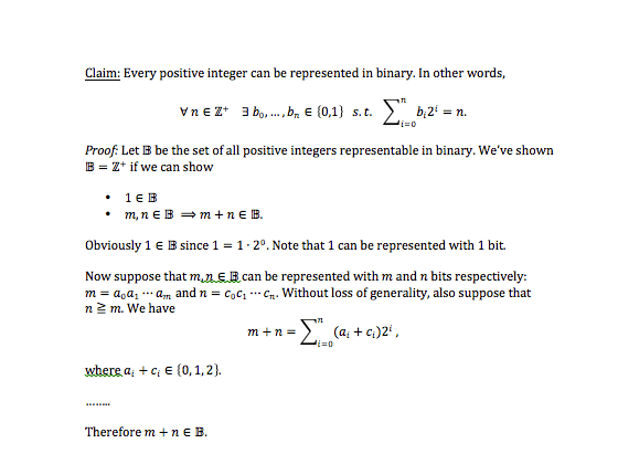

I'm assuming this is a simple proof? I started thinking about it.
It suffices to show that every even number can be written as positive powers of 2 (since every odd number is simply an even number plus 20). So let n = 2k for some non-negative integer k; we need to show that 2k = 2c1 + 4c2 + 8c3 + ... where each of c1, c2, c3 ... is 0 or 1.
(Where do I go from here? Some sort of iterative scheme?)

Let [itex]X= \{ n \in \mathbb Z_+: \enspace n \text{ can be expressed in binary}\}[/itex]. You want to show [itex]X=\mathbb Z_+[/itex]
Try to prove the following lemma: If [itex]m,n\in X,[/itex] then [itex]m+n\in X[/itex]. Mathwonk's suggestion should give you a method of proof for the lemma.
This may make your induction easier.
(I'm not adding new content really... I'm just suggesting a way to organize your thoughts on this.)
I see.
Ok, guys ... I'm starting to write out a formal proof but I'm having trouble finishing it off in an elegant way. It looks like it's going to get messy trying to show that m + n equals a sum of powers of 2. Or am I missing some obvious, simple recipe?
Instead of working with ##m+n##, you might try working with ##m+1##. If ##m## can be expressed in ##m## bits, how many bits worst case are required to express ##m+1##?
m+1 worst case
