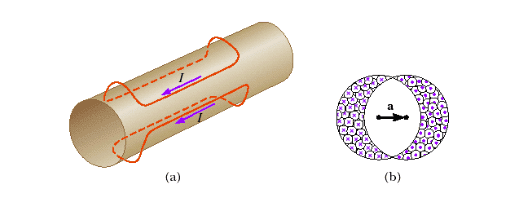

We have seen that a long solenoid produces a uniform magnetic field directed along the axis of a cylindrical region. However, to produce a uniform magnetic field directed parallel to a diameter of a cylindrical region, one can use saddle coils. The loops are wrapped over a somewhat flattened tube. Assume the straight sections of wire are very long. The overall current distribution is the superposition of two overlapping circular cylinders of uniformly distributed current, one toward you and one away from you. The current density J is the same for each cylinder. The position of the axis of one cylinder is described by a position vector a relative to the other cylinder. Prove that the magnetic field inside the hollow tube is ##\frac{\mu_0 J_0}{2}## downward.

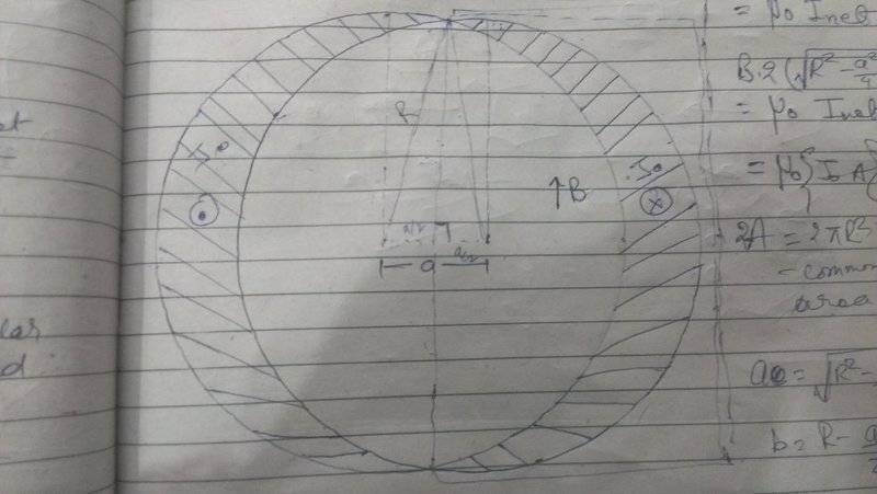

I have attached a figure with the post, to show how I perceive a "part" of the problem - specifically -
Considering that the sketched portion of cylinder should be carrying current, while the unsketched is not, area of sketched part comes out by substracting the area of 2 discs with area of ellipse(unsketched part). But that does not give the required answer. Further the unsketched portion may have a constant magnetic field. The current distribution is not completely symmetrical.(consider a point inside the unsketched part of cylinder close to rim and other at middle - current does not quite appear to be symmetrical about these does it?)

If I have to consider a coil, a wire - then current density holds very less meaning as generally area is both constant and small. Further if I have to consider that the tube is hollow then my procedure was completely incorrect, but then current density can hold meaning if current flows through the surface of cylinders.
As I said the difficult part of the problem is actually getting the figure straight- Is it what google says, or does it have loops of wire or is there current flowing through the surface of cylinders or does the current flow through the volume of cylinders like in my diagram? Or maybe none of these and current is simply flowing on the moon.

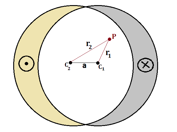

It will give the correct answer. Use the superposition principle for magnetic fields. Each entire cylinder produces a magnetic field at some point P in the overlapping region. You do not need to worry about finding the area of the colored regions in the picture attached below.
EDIT: I believe that Dewgale is considering the directions of the currents to be opposite to the directions shown in the picture below. He appears to be considering the case where the net field will be downward.

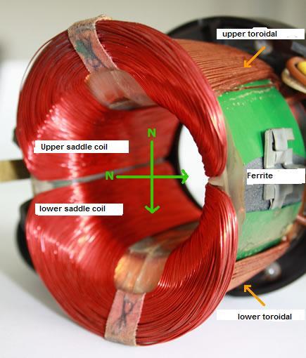

My interpretation of the figure in post 4 is shown below. You want to concentrate on the currents in the saddle coil wire that run along the straight sections of the coil inside the cylinder. I have tried to indicate these currents by the blue arrows. I have chosen the direction on the left side to run away from us. The current runs in the opposite direction in the wires that are hidden from our view but which I indicated with blue arrows coming toward us. If you imagined looking directly into the cylinder, you would have current distribution similar to the overlapping cylinder current distribution (with current coming toward you on the left and current running away from you on the right).
You should ignore the "toroidal coils" shown in the figure.

I do actually have a picture of the situation:
I've had to hand in the assignment already, but I'm still very curious as to how to make this work.

The statement of the question said that the answer should be ##B = \frac{\mu_0 J}{2}##. But this doesn't have the right dimensions to be a magnetic field. It is probably a misprint. I believe the answer is ##B = \frac{\mu_0 J a}{2}##.
For a single cylinder with uniform current density, you were able to show that ##B = \frac{\mu_0 J r}{2}## for points inside the cylinder. Let ##\hat{k}## be a unit vector pointing in the direction of the current density. Verify that the magnitude and direction of ##\vec{B}## are correctly obtained if you write ##\vec{B} = -\frac{\mu_0}{2} J \; \vec{r} \times \hat{k}##, where ##\vec{r}## is the position vector locating the field point relative to the axis of the cylinder.
Then consider the superposition of two cylinders with opposite current and axes separated by ##\vec{a}##.
