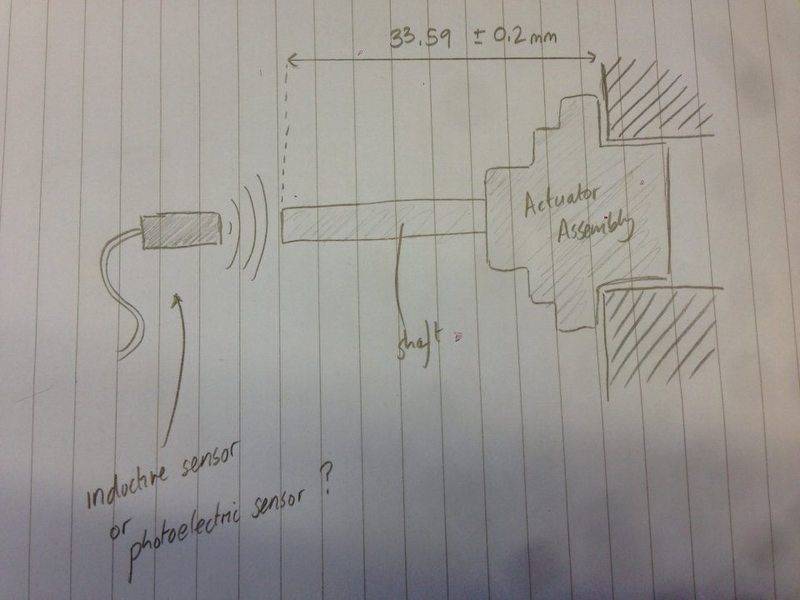

I've taken a year out of university to work at a design company and they have given me a project to design/make a test rig which measures the position of a metal shaft within an actuator assembly to check if its within a +/- 0.2mm tolerance. Some of the key requirements are:
  • No contact with the shaft
  • The sensor is going to measure the end of the shaft to check if its within +/- 0.2mm tolerance. Therefore it would need to be able to read a change of less than 0.1mm.
  • Output must be repeatable as it is going to be used to measure a handful of parts off the production line
  • It needs to be easy to use/ display results clearly
  • measured shaft has a diameter of 5mm
I've been looking at inductive and photoelectric sensors from http://www.baumer.com/uk-en/ however I can't find a product which can accurately measure the position of the shaft down to 0.01mm

Perhaps a laser interferometer pointed at the end of the of the actuator? You will either need to secure the assembly securely each time (a pain to do right every time) or measure both the rod and the mounting and tare (can be built into the device with some extra engineering).
This is a problem that has been solved many times. There is an industry dedicated to machine tool alignment. I'm sure you can buy a solution or build one yourself.

As for the actual problem though you could do that with a £20 dial gauge if direct contact was acceptable .
Direct contact measurement is very common practice in this sort of application .
If non contact is essential then have a look at this sort of thing :
http://www.optimet.com/industrial.php?gclid=CJ2f5KLI2McCFUZAGwodGB4HvQ

I agree. Why is there a non-contact requirement?
Maybe it's exaggerated, but a camera will do it and is very flexible ( can look for other things than just the shaft position ).
Say you have a camera with a physical image width = 50mm and a line resolution = 1280 pixels, you can measure the position within ±0.0078mm ( ±0.2 pixels ).
Connect the camera to a PC ( framegrabber ), and you have a whole screen to display results, a disk to save them, a processor to calculate statistics.
The lens of the camera has some distortion, but you can correct it by an algorithm.

One possiblity is a linear ccd array and lensing system that projects the end of the actuator shaft onto the ccd array. (similar to the camera solution previously suggested)
There are industrial line cameras and frame grabber systems designed for exactly this sort of thing. Not a cheap solution though, but very flexible in an industrial environment. Maybe it would have other applications in the quality control dept.
Anything you do with reflections, etc will have issues and be limited in flexibility.
Contact DALSA to get your bearings in that market.
http://www.teledynedalsa.com/imaging/products/cameras/line-scan/spyder2/S2-1X-05H40/ for example
I'm sure you can find cheaper solutions than DALSA depending on how much circuit design you want to do.
A non contact measurement system may be necessary if an object is fragile or has moving parts where any hard contact could change the end length .
The cryptic word 'actuator' in the original diagram could imply a moving spindle . Depends then on how much force is needed to move the spindle any significant amount .
Non contact end length of such small parts could be done with a Mitutoyo bench laser micrometer adapted with a holding jig .
A problem with non contact end measurement is that there are no forces into the specimen to bed it down against a stop giving reliable base reference position . Holding jigs usually have to have some level of end clamping to deal with this problem .
With a camera, you don't have to keep the object to be measured in known position. If just the object is within the frames of the image, a program can move/rotate the object digitally, if desired. A picture can even be taken "on the fly" ( object is moving ) in strobe light, corresponding to a shutter time ≈ 1.5μs. Also the camera can detect "mechanically hidden" errors, like a scratch in the surface of the object.
