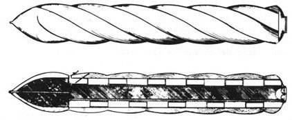

12" diameter, nose rounded or half ovoid; no taper, no fins. Body of torpedo was grooved or channeled with six helical flat surfaces designed to maintain spin as water flowed past; initial spin (in the tube) was via a half dozen lateral vents. No pictures exist . . .

Welcome to the mystery! Regarding nomenclature, this is a time when the standard phrases were not yet fixed and old words were being used in a new way. "Torpedo" had been static, and mostly was during the Civil War, but the original use (in the 1810s) was a sea mine detonated by electricity (Fulton)--hence use of the name of an electrically-charged fish. "Torpedoes" were also impact firecrackers, which are still in use today--this shows the transfer from a word based on electric detonation to any similar detonation. Water rockets had been around for decades--Hale being the most famous inventor, who had developed his rocket based on Congreve. But nobody yet used the term torpedo for these. The first fellow to do so was Pascal Plant in 1862 in his US patent for "Improvements in Rocket Torpedoes." Whether he coined the term or it was simply gaining traction--unknown. But a number of designers then used the phrase for any rocket-propelled underwater projectile. By the end of the war, the "torpedo" part stuck for any type of automobile missile.
As per the very sparse records and later descriptions, the lateral vents that began rotation were in the stern of the torpedo; these were not meant to maintain spin. An officer writing in 1887 says "Hunt used grooves cut in the housing," while another--a torp instructor at the USN Torp Station in Newport, RI in 1871--designed a torp that quite probably owed much to Hunt. His projectile had such pronounced "lands" (the ridges between the grooves) that it looked like a coiled rope. Hunt may have done this, but his 1862 model was more probably based on the then-advanced style of rifling developed by Whitworth in England. "Whitworth rifling" meant cutting flat faces in a helical pattern around the surface of the shell housing in long spirals that began behind the rounded nose and continued down the entire length. This did not make an exact hexagon; instead the flat faces were separated by six sections of the original shell body. Imagine using a slightly-oversized hexagon to trim the axial profile of the torp, which would leave flat surface - rounded surface - flat surface - etc.
Maintaining depth was a challenge. Hunt's first trial ended with the torp going about 150 feet, shooting above the surface for another 150 feet, then going underwater again for an unknown distance. Several months later he had resolved this problem, as, by June 1863, a second demo ended with "the complete approval of the Army and Navy officers who witnessed it." So Hunt made this thing work--somehow.
If we discount supercavitation because the vents are at the rear, the device becomes a submarine “displacement hull” analysis. That reduces the complexity of the possible Velocity–Range trade-off.

Unfortunately not. That would be an indication of how much gas was being allowed to escape. Patents of other torpedoes, strangely, have what look like excellent engineering drawings--but which carry no hint of scale! Eyeballing suggests a 1" exhaust. Best I can do is wait for a contact at the Naval War College to let me know if they have schematics of an 1871 torpedo that is about the same size as Hunt's 1862, and see what was used at that time. I am expecting one inch.
Here are two images that may help clarify my descriptions. The 1873 torpedo has very deep grooves and prominent lands--almost to the point of looking like twisted rope. It measures seven feet in length, which will give an idea of the size of its twin exhaust vents. The 1862 torpedo probably used a different style of external rifling, as per the second larger image, which shows a profile; the grey is the final shape.
