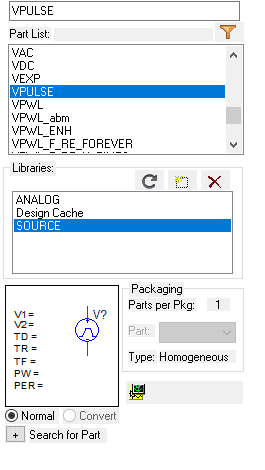

So, we're dealing with two versions where we change the numbers. I get that. My problem is that I cannot find that particular Pulse Generator anywhere in the PSPice library. I also checked my leaflet, and can't find a single example where the circuit is left "open" at the sides (the Uo part). I checked the internet and the program's website, and I'm getting that the generator for square pulses is:

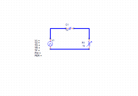

Furthermore, as I have no other examples of such circuis, how am I suppose to create that in PSPice? I can do this (disregard the C and R values/names, this is just a quick example:
How am I supposed to add the "free ends" to the sides? Just add two more wires/buses? Then I suppose I should place the ground. However, as I'm not even sure if that's the correct Pulse Generator, I don't know how to proceed with the values I've been given.

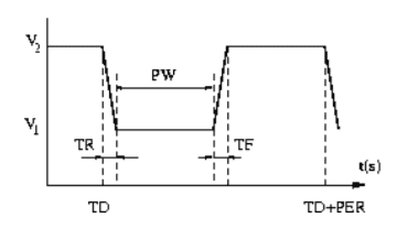

Hmm, that's a lot of words and I'm having a difficult time trying to understand your question. Is it: How to set up VPULSE to get square waves or what should you use?
I grabbed this from an old lab notes from the university I attended. I would bet my university got it from the cadence support site or maybe the's a help option somewhere. I don't have PSpice on my personal computer so I couldn't check, but I think the above would be sufficiently helpful, yes?

OK, so we don't need to solve your problem until next year. But, a comment about using simulators, which you will want/have to do in the future.
They can be a real PIA to set up. There are a lot of test circuits that you'll have to do just to figure out how to get what you want. So, in this case of a pulse generator with confusing documentation, what I would do is make a circuit with just the generator and a resistor and make measurements to figure out how to get the wave form you want. It is usually less work than wondering if you read the documentation correctly.
Too many people put in a circuit and only measure the output. But then how do you know that you haven't made a mistake? The best way is to build your circuit up piece by piece, gaining confidence with each step that it is correct so far. Later you can skip some steps when you have used the particular simulator enough to be proficient.
