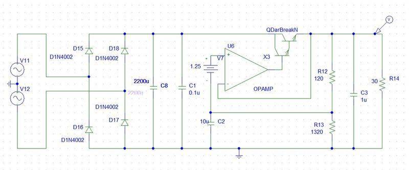

I'm using a LM[Three-One-Seven] to regulate dc voltage output from mains power(240V ac). For PSPICE simulation, I was instructed to use an ideal OpAmp and Darlington BJT to model the IC in PSPICE. I came up with the following model, which satisfies the equation Vo=Vref(1 + RL/RH), where Vref = 1.25V(nominal voltage for the IC). Function of the circuit is to supply power to another device.
[For OPAMP, VPOS = 50V, VNEG= -50V]
I tried using a dc input to the circuit and it works as expected i.e. Output voltage = 1.25(1+RL/RH) for any input voltage and load resistance as long as the input is higher than the desired output. For example, having RL=1320, RH = 120 and Vin = 10, I only obtain 10.2V instead of 15V.
To obtain power from the mains, a transformer and a rectifier is required. So firstly, I attempted to simulate the circuit without the transformer.
I have tried connecting a AC source(VSIN) to a full-wave diode rectifier(w/ smoothing cap) to the circuit. However, the circuit still gives a output of 15V(same resistor values as example above), for any VAMPL of the VSIN, even VAMPL = 0. I used two VSIN with ground in the middle because PSPICE requires me to ground that loop else I get an convergence error.
What is the mistake I'm making? I tried the function of the rectifier seperately in a simple test circuit, and it works fine. Is it something to do with the OPAMP's VPOS and VNEG? It didn't seem to affect during the test with dc input. Or is the current being drawn for the source(although the voltage isn't sufficient) to give the desired voltage at the output? If that's the case, do I need to use the transformer to isolate the regulator from the source? I have tried using XFRM_Linear as a transformer and still have the same undesired results.
Please tell me if any clarification is needed. Thank you in advance.EDIT: The circuit still gives 15V output WITHOUT any input source connected. Only sources remaining are the 1.25V VDC for the reference voltage and the supply to the OpAmp

I haven't used spice for a long long time but...
When the input voltage is set to zero is it possible the circuit continues to power itself from C8? Perhaps monitor a few more nodes in the input side. See what the voltage is on C8 when the AC input is zero.
There's 15.68V DC at the input side, with or without the smoothing cap (in fact with or without the input bypass cap too).
Weird. Has to be a bug somewhere in the model.
It has something to do with the diode and the op amp. The power to the output comes from the OpAmp supply. During the test without the rectifier, the input(Vin) of the regulator is connected directly to the source(VSIN). So Vin must = VSIN. So the source is the one limiting the output voltage. Using the rectifier, Vin is not forced to = VSIN. So Vin goes up to any desired value to give the output voltage as 15V, again the power coming from the OpAmp. The difference between VSIN and Vin, is dropped across the diode (forward bias voltage), which in practice may break the diode.
The voltage across the diode is not forced to be = forward bias voltage (e.g 0.6V). Either something is wrong with my regulator model or I should use a different diode, if it helps?

Yes. :biggrin: When you use a high-powered OP-AMP it can supply all the power you need, there is no requirement for the transformer and rectifier! The regulated output is all sourced from the OP-AMP; being ideal it has no trouble compensating for the Darlington Pair's gain being very low (read, 0).

You could try restricting the OP-AMP's output capability.
The only parameters of the OpAmp I can change is its supply. I tried setting it at 5V, but it is limiting the output voltage.

For starters, you could add a resistance in series with the base of the Darlington Pair to limit the drive current from the OP-AMP.
Likes 1 person
Adding a high value resistor at the base of the darlington pair seemed to do the trick. Even at 50V op amp supply, sufficient voltage is required from the source to provide an output voltage of 15V. I used an 8k resistor, are there any recommended value I should use instead?
From what I understand, the most of the voltage from the opamp output falls across the resistor, whereas only the *forward-bias voltage appears across the base-emitter. Earlier, all of the voltage appears across BE, hence the OpAmp supplies the output voltage.
Please correct my understanding if necessary. Its very important for me that I understand completely anything I work on or learn.
Whoa! I didn't have in mind kΩ! I thought a few Ohms might do, enough to limit the base current to about 5% of the load current. Or pretend the Darlington Pair has a gain of, say, 40, and work backwards.

You don't seem to have indicated over what power range you wish to test this model. The required value of added resistance is load dependent. With no load, it may indeed need multiple kΩ. (A resistor may not be best representative of a real OP-AMP, perhaps a current limiter. But I think a single well-chosen resistor may well suffice provided your needs are modest.)
For this simulation, load current absorption is to be assumed as 0.5A, hence 30 Ohms load resistor.
I get no difference in outpt for op amp resistor value varied to different kOhm values. Like I mentioned earlier, values in the tens or hundred ohms give me a convergence error. I'll assume the value as 8k for now.
