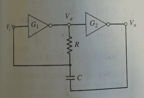

I'm trying to simulate the following circuit in OrCAD PSPICE.

Resistor and capacitor values were chosen for some arbitrary time constant. I just wanted to see the waveforms at Va, Vo and Vi.
V(2) corresponds to the gates of the first CMOS and I set that to 5V to "start" the circuit. However, I'm not seeing any oscillations when I simulate the circuit.

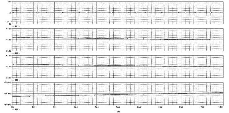

Give us the voltages at input and output of both inverters. Also your Vcc and Vdd.
The output plots? Alright. I'm assuming you mean the capacitor voltage when you say Vcc.
V(1) is VDD = 5 V, V(2) is Vi and Vcc (same node), V(3) is the output of the first inverter, V(4) is the output of the second inverter.
Run your simulation longer! It's clear that V3 and V4 are changing.
How can Vi and Va both be +4.4V?? Are you sure you're running an inverter? What's the part number? Oh, I bet it's your model.
Vi and Va look like the same voltage.
R looks like no current thru it.
I seriously question you model of the device. Pick an actual part number from the list of devices in your PSPICE library. Example: 74HC04.
