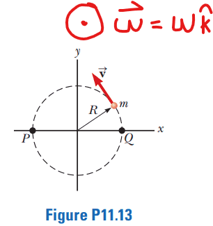

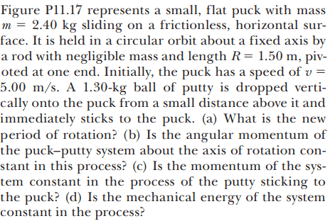

For this problem,

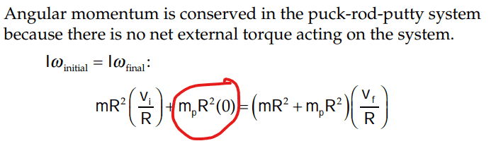

Why for part (a) the solution is,
Is the bit circled in red zero because since the putty is released at a very small distance above the rod it velocity is negligible?

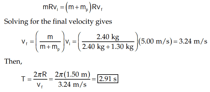

Also for part (d) the solution is
I did a computation of the initial and finial kinetic energies of the system and found:
##KE_f = \frac {KE_im_i} {2m_f} ## so I guess that's why the finial KE is less than the initial.
The putty has no velocity component in the plane of rotation, so its initial angular velocity is 0. The fact that it is released a small distance above the puck allows to neglect what happens out of the plane.
The final KE is indeed less than the initial but twice as much as what you have.
Thank you for your reply @DrClaude!
Sorry, what do you mean by the putty has no velocity component in the plane of rotation?
I've tried to draw it out:
Since the problem does not specify where the putty is dropped onto the puck during the rotation, I thought that if it was dropped during the second quadrant of motion, such as when the puck is at point P, then it would have vertical velocity exactly in the direction of the puck's tangential velocity?
Is you second statement about neglecting what happens out of the plane referring to the fact that the problem states that the putty is dropped a very small distance above the puck then when we can neglect its vertical velocity?
Many thanks!
Thank you for your reply @kuruman ! I found my mistake :)

One of you is correct and one of you is wrong. Which is which? I will tell you what I think after you tell me what you think and why.
I don't think angular momentum is conserved before the collision because there is a torque due to gravity acting on the putty.
I think the statement in the solution must be referring to during and after the collision.
I think during the collision the impact force from the putty on the puck will be equal to the normal force from the puck onto the putty. I think this is possible if the surface that the puck is on has infinite inertia, so will not accelerate during the collision but will exert a infinite force to slow the puck instantaneously. Since the net force is in the z-direction, then there must be a torque due to the normal force about the z-axis though plane of rotation. However, since this torque is perpendicular to the plane of rotation (and angular momentum of the puck), then it cannot change the puck's angular velocity and therefore angular momentum of the puck.
However, I now realize that during the collision, the putty will lose some of its angular momentum about the AoR. Does that mean that angular momentum is not conserved during the collision?
Maybe it's only a component of the angular momentum of the system putty + puck system that is conserved during before, during, and after the collision.
Many thanks!
Many thanks!
This all seems to be getting unnecessarily complicated.
Note the wording of the question: the angular momentum of the puck-putty system about the axis of rotation…
Since gravity acts vertically, it has no torque about that axis.
Perhaps I'm missing a shift somewhere in the thread to considering the total angular momentum about the centre of rotation of the puck, just out of curiosity. But it is still no big deal.
When the putty hits the puck, there is a vertically upward impulse from the ground exactly matching the impulse gravity applied to the putty while it was falling. Thus, the total angular momentum of the system is suddenly restored to what it was before the putty was released.
Likes member 731016
It may seem to be getting complicated because I was trying to get @Callumnc1 to see that the statement "Angular momentum is conserved in the puck-rod-putty system because there is no external torque acting on the system" is simply wrong and needed fixing. The fix is that there are torques acting on the system but not in the vertical direction which is what matters. Thus the vertical component of the system's angular momentum is the same before, during and after the collision. Initially @Callumnc1 thought that
Callumnc1 said:
I don't think there is a net external torque because during the collision there is no movement of the puck and putty system in the ##\hat k## direction.
is the justification for angular momentum conservation. That, I thought, revision preferably by @Callumnc1 with some guidance.
Likes member 731016
I don't think there is a net external torque because during the collision there is no movement of the puck and putty system in the k^ direction.
Then here's my answer to that..
It's not whether there is movement but whether there is change of movement (acceleration). The putty’s movement changes considerably during the impact.
Likes member 731016
  • #31
Thank you for your replies @haruspex and @kuruman !
So since gravity is acting in the ##\hat k## direction means that the torque due to gravity on the putty is along the plane of rotation.
This means when the putty collides with the puck then the angular momentum of the puck in the ##\hat k## direction cannot be changed since the putty angular momentum dose not have component in the ##\hat k## direction since when it is falling is has angular momentum along the plane (in either the ##\hat x## or ##\hat y## direction or both) given by the right hand rule.
I see now that the solution should have specified that angular momentum is conserved in the ##\hat k## direction about the AoR. Now I see that they should have applied conservation of angular momentum in the ##\hat k## direction which is why the putty's angular velocity is zero.
Many thanks!
  • #32
Why? "about the axis of rotation (of the puck)" implies the ##\hat k## direction.
Likes member 731016
  • #33
Thank you for your reply @haruspex ! True it dose imply ##\hat k## direction.
