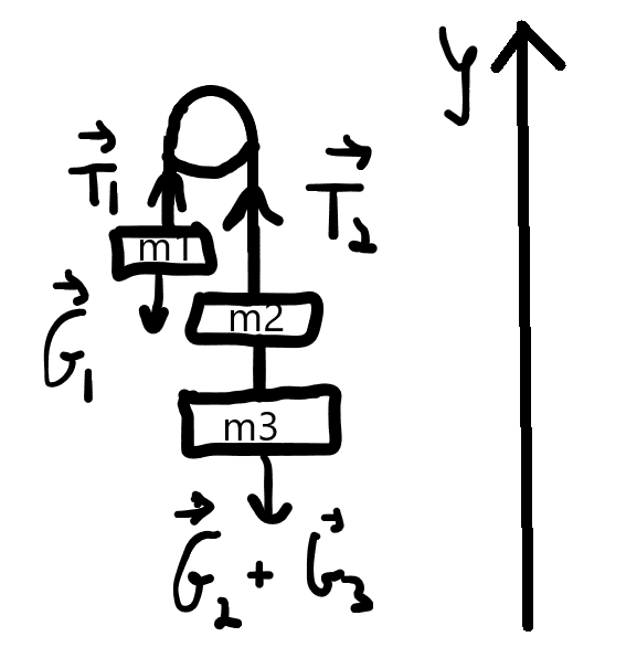

In summary, the problem involves determining the acceleration of three bodies with masses 25kg, 1kg, and 3kg, and the tension of two ropes. The friction and mass of the pulley are neglected. The problem can be solved using the equations T1-G1= m1*a; and T2-G2-G3 = -(m2+m3)*a;, assuming the accelerations are the same. If the accelerations are not the same, the problem becomes more complicated. However, if we assume that the pulley is ideal, meaning it changes the direction but not magnitude of tension, we can find a relation between T1 and T2 which can then be used to solve the problem.
inv4lid
Determine bodies' acceleration if their masses are the following: m1 = 25kg, m2 = 1kg, m3 = 3kg and the Tension of the ropes. Friction is neglected, as well as the mass of the pulley. It is considered that the ropes are perfect.
m1 = 25kg;
m2=1kg;
m3=3kg;
___________
a=?
T1=?
T2=?
For the first object we have:
T1-G1= m1*a; (the acceleration is oriented upwards)
a = (T1-G1)/m1;
For next ones, I guess:
The acceleration here goes downwards
a = (T2-G2 - G3) / -(m2 + m3)
Are the accelerations the same?
How would i find it?
What would happen if the accelerations were not the same?
You may safely assume that this is an ideal pulley, i.e. it changes the direction of the tension but not its magnitude. This will simplify your work.
I need to get some numbers. How would i get the tension/acceleration? There is too much unknown data.
(i guess we can't get any of T)
I think kuruman is trying to get you to relate ##T_{1}## to ##T_{2}##. If the pulley is ideal (frictionless and massless) what is the relation? Once you have the relation, you can solve the algebraic system.
