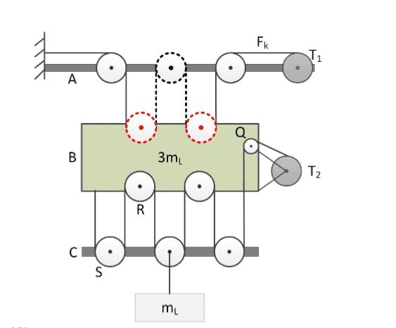

Suppose mass mL has a constant vertical speed v while hoisting, block B is stationary. In that case, calculate the rotational speeds ωQ, ωR and ωS of discs Q, R and S expressed in v and D. Define clockwise as positive
v=omega*radius
length_a+length_b= constant
Further given:
- every beam is infinite stiff
- pulleys are massless
- cables don't stretch, no slip, and frictionless.
-Every pulley has a diameter D except pulley Q. Pulley Q has diameter 0.5*D
So what I don't understand is how to calculate/determine the velocity at R and S. Can someone help me or send me into the right direction? I know from the answers that the velocity at R is 2v and at C is 1v, but I don't understand why.

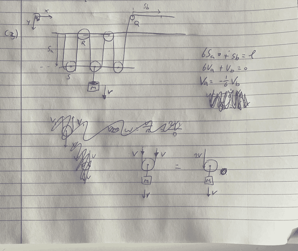

I would start by relating the total length of the bottom cable to the height of the bottom platform. The rate of change of length of the cable will be the rate it is being taken up by ##T_2## and give you rotation rate of Q.
Likes jeffrey
Consider that each vertical section of string may have a different velocity.
What is the velocity of the leftmost? What about the one between S and R?
Likes jeffrey

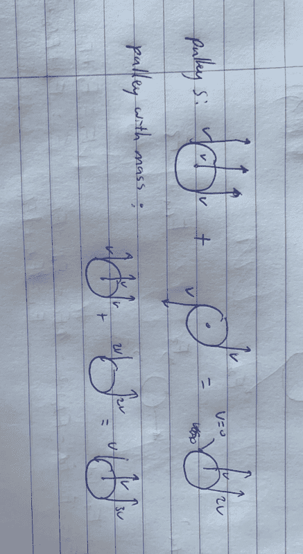

The rope between R and the pulley with the mass should also be 2v then, because it is the same piece of rope. But the pulley with the mass does move upwards so left of this pulley the rope has a speed of v and right of it the speed is 3v (I don't think that this part is correct ).
Closer... but it went from zero to 2v in going around pulley S, not from zero to v.

ω*r gives the velocities at the left and right side of the pulley S, this gives a v upwards for the right side and v downward for the left side. This is the velocity by rotation, but the pulley also translates with a velocity v. This the translation v is for the left middle and right side the same. So, it adding the left side gives 0, for the middle v, and right 2v.
Good, so apply the same reasoning to the next pulley along.

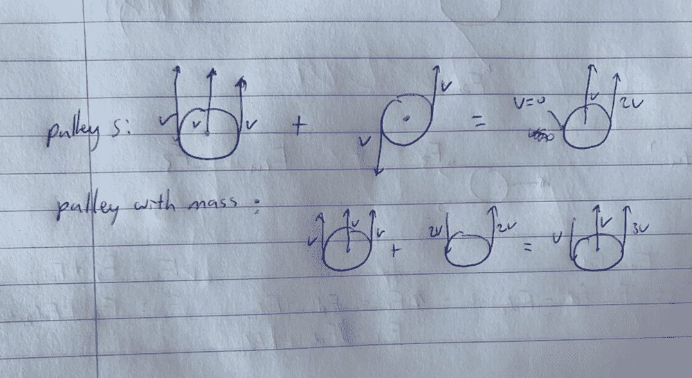

Okay, that one rotates with a velocity of 2v but translates also upwards. So what I'd say is that the left side moves with 2v-v, the middle v and the right side 2v+v.
How fast is the string on its left moving down? If the pulley were not moving up, how fast would it be rotating? Does its upward movement change that?
It is moving down with 2v right? So if it were not moving up it would rotate with 2v/r. I think the upward movement does change it. The upward movement gives the left, middle and right side a velocity of v upwards. While the rotation gives the left side a velocity of 2v downwards and 2v upward so adding the velocities does change it.
Or am i thinking wrong?
You lost me somewhere in there.
We know the left is moving down at 2v and the centre moving up at v. So what is the rotation rate, and what does that make the velocity of the right side?

If the rotation rate is ##\omega## then the left hand side is moving down at ##r\omega## relative to the centre. The centre is moving up at v, so the net velocity of the LHS is down at ##r\omega-v##, but we know that it is moving down at 2v, so we have the equation ##r\omega-v=2v##. This gives you the rotation rate.
Write the corresponding equation for the RHS.

RHS would be ##r\omega+v=4v##, with r*omega being 3v right.
jeffrey said:
Thank you a lot!
Yes, so now you can see the pattern: each turn around a lower pulley adds 2v.
