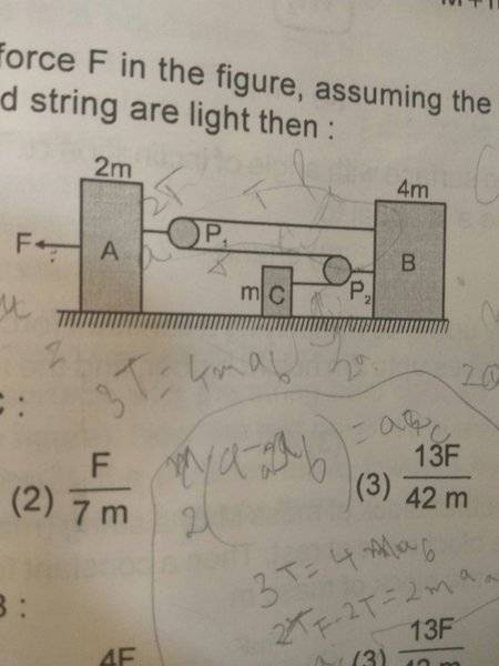

Need to find the acceleration of the blocks, all surfaces are smooth : https://drive.google.com/file/d/0B5bF4yPQOejoazhWeEgySmtfSnc/view?usp=drivesdk
a1 + a2 + a3 =0 (acceleration of strings lengths must sum to zero)
F = ma
Acceleration of topmost string = a_a(acceleration of block a)
- a_b (is this right? I feel like this should be right but idk why)Acceleration of middle string also must be the same
And acceleration of bottom string is simply T (where T is tension in the string, assuming mass is 1)
3T = 4a_b (for block b), F - 2T = 2a_a, T = a_c.
Solving all this gives me the wrong answer : /I'm suspecting somethings wrong with the first step, is it?

Hello ,
Next time please try and upload image on PF using upload button .
Your constraint equation isn't correct . Can you express the length of the string in terms of the displacements of the three blocks .

Hi
I had significant difficulty in uploading the image so i had to use drive : /. In terms of displacement you say? I'm finding it difficult but so far I've got this : change in top length of string = x_a(displacement of a) - x_b, change in middle length of string =x_a-x_b + x_c, change in bottom string in just x_c, they should all sum to zero right?

No .
Place your coordinate system to the right of block B . Left direction is taken positive. Let A at any instant be at distance x1 from origin , B at x2 , C at x3 .
Use a pen and a paper , think carefully and tell what is the length of the string in terms of x1,x2,x3 ?

Is it 2(x1-x2)+ x3 = l ? You'd have subtract that little bit of string attached to p1 and p2 so 2(x1-x2)+ x3 = l+2q , so i differentiate twice and I'll get constraints. Thank you

No . Aren't both blocks B and C moving :wink: ?

Right, x2 - x3 then?

Should that be x3 - x2 ?

Yes! So now my equations are :
2(a1-a2)+a3-a2= 0,
1 - 2T =2a1, (assyming F = 1 and m = 1
3T =4a2,
T =-a3 (minus because its going opposite to coordinate system)
Does this look alright? I'm not getting the right answer. (except for block b whose accleartion is equal to that of the centre of mass, is this a coincidence?)

What is the direction of tension on C ? In F= Ma , you put a sign on the force , not on the acceleration term :smile:

Ah that makes more sense. Rest of the equations are alright right?

a1 =13/42, according to the book its 4/21 (at F=1, m =1)

I am getting a1 = 13F/42m , a2 = F/7m , a3= -4F/21 .
May be the answer key is wrong .

Thank you for your help, I've been struggling with these constraints problems for quite sometime, now it makes sense . It looks like my books actually wrong, its a nondescript college issued workbook. Oh btw is the fact that accleartion of block b = acceleration of centre of mass a complete coincidence?
Edit : it isn't! When i change b to 5, the acceleration of cm is 1/8, as expected! Why is this happening?
Mathematically they have same value in this problem.But that is due to string constraint and for the particular masses as given in the problem .
The CM of the system has a different location than that of block B , but due to string constraint and specific value of the masses as given in the problem, their accelerations are turning out to be same .Quite interesting !
