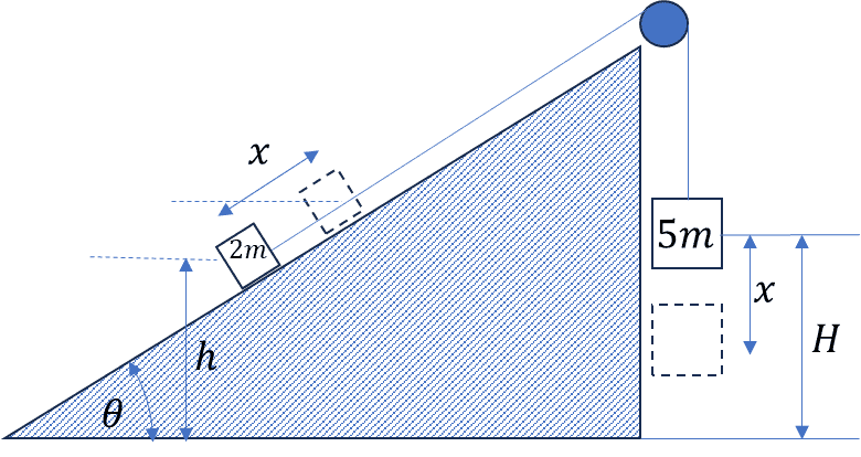

Dear all I have the following problem with my working attached as a PDF.
I want to calculate how far particle a travels after the string has snapped. The question says the particle A travel for 1m before the string snaps. The question asks me to use energy methods to do this. The total distance is 1.51m according to the book. I am getting 1.52 m, but it my working I am trying to solve for the extra distance after the particle has travelled the 1m. Thus, I am looking to get 0.51m.
Please see my working in the attachment.
Many thanks

This is the question from the book:
The diagram shows a particle A of mass 2m which can move on a rough surface of a plane inclined at an angle theta to the horizontal, where sin(theta) = 3/5. A second particle B of mass 5m hangs freely attached to a light inextensible string which passes over a small pulley. The other end of the string is attached to particle A. The coefficient of friction between particle A and the plane is 3/8. particle B is initially hanging 2m above the ground and particle A is 4m from the pulley. When the system is released from rest with the string taught A moves up a line of greatest slope of the planes.
a) Find the initial acceleration of A? (answered)
When B has descended 1m the string breaks
b) By using the principle of conservation of energy calculate the total distance moved by A before it comes to rest?

Hi @Tygra. Despite mistakes I’d say your general strategy is OK.
No one has yet mentioned the following; you have written:
##(\frac 65mg + \frac {24}{40}mg)x = 8.96m + \frac 65mgx ##
which you need to revisit.
Make sure you understand the physical meaning of the terms in the equation and make sure there is no ‘double-counting’ of any sort. (It may help to remember that work done by gravity is the same thing as minus the change in gravitational potential energy.)
Correcting and solving the above equation gives the required answer (fortunately, despite any other mistakes you have made)!
You will find it a very useful learning-exercise to present a complete, updated solution here, as already suggested, and to get the feedback.

Here was my thinking:
The kinetic energy at the moment before the string breaks is 8.96 Joules. Since the particle A comes to rest then change in kinetic energy also equal 8.96 joules.
The gravitational potential energy increases. I have taken the datum level for the GPE to be the height the moment the string breaks (Not sure if this is correct - probably not).
So the GPE gained in 2mg*sin(theta)x = 2mg*3/5*x = 6/5mgx (where x is the distance particle a travels up the plane before coming to rest).
Then by considering the energy change you get 8.96m joules + 6/5mgx joules. Then equate this to the work done on particle A.
I'm not quite sure where to go from here. So any more help would be much appreciated. Thanks

Thanks Steve and Kuruman, I have the correct answer now.
Like you said, Steve, I can set it up like this:
## (\frac {24mg}{40} + \frac{6mg}{5})x = \frac{224m}{25} ##
## \frac {9mg}{5} x = \frac{224m}{25} ##
## x = \frac{225(5)}{25(9)(9.8)} = 0.51m##
Thank you again for your help!

As an alternative you can start with:
$$ \int \mathbf{F_{n.c.}} \cdot d \mathbf{\ell} = \Delta KE + \Delta PE \tag{eq1} $$
$$ -2\mu m g \cos \theta x = - 5m g x + 2m g \sin \theta x + \frac{1}{2}( 2m + 5m ) v^2 \tag{eq2}$$
Then you can solve directly for ##v^2## (the initial velocity of the masses just before the rope snaps). Then you can re-apply ##\text{eq1}## to the mass on the incline to solve part b)
to get the acceleration ##a## from part a) just differentiate ##\text{eq2}## w.r.t. time ##t##.
