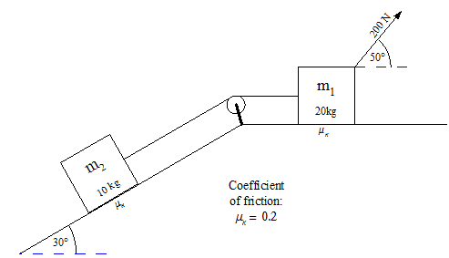

1. A mass on a flat surface is pulled with an angled force of 200N (as shown) and is connected by a massless rope/pulley to another mass below on an incline. Find the acceleration and Tension in the rope.
Fnet = ma
Fg = mg
Ff = Mu x Fn
Had a question like this except with different masses/angles on a quiz and want to make sure I did it right.
Would the equation for M1 be Fnet = Fappx - Ft - Ff
And for M2:
Fnet = Ft - Ff - Fgx
And then you turn Fnet into ma, combine the two equations to make Ft cancel out, then solve for a since acceleration is the same for both masses in a pulley system?

Yes. This looks right.

Great! And for the normal force on M1 (to figure out friction), would it be M1g - 200sintheta ?
Yes. But you have not said what you mean by Fgx and Ff for M2.
Oh, I meant Fgx is the x component of the force of gravity so (mgsin30) and Ff is = Fn which is equal to the y component of Fg so Ff = (0.2 x mgcos30)
