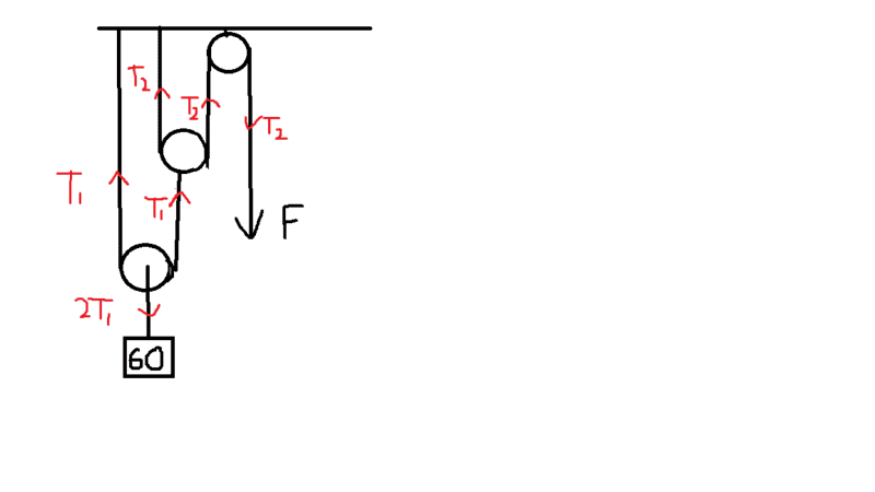

Hi, I have this pulley question, i have to find the force F that needs to be applied to the string to keep the system in equilibrium. I found 150N.
Is it correct?
T_1= 300N and T_2=150N so F is 150N.
Likes sophiecentaur
Using earth gravity as 10N (vs. 9.8), looks good to me.
Likes vanhees71 and Tesla In Person
Nitpick: The tensions in the strings do not have direction so it makes little sense to draw them as arrows. It is only when you cut the string in a free body diagram that you get directed forces.
