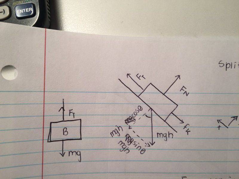

Two blocks are connected by a string that passes over a massless, frictionless pulley, as shown in the figure. Block A, with a mass mA = 4.00 kg, rests on a ramp measuring 3.0 m vertically and 4.0 m horizontally. Block B hangs vertically below the pulley. Note that you can solve this exercise entirely using forces and the constant-acceleration equations, but see if you can apply energy ideas instead. Use g = 10 m/s2. When the system is released from rest, block A accelerates up the slope and block B accelerates straight down. When block B has fallen through a height h = 2.0 m, its speed is v = 5.00 m/s.
a) Assuming that no friction is acting on block A, what is the mass of block B?
(b) If, instead, there is friction acting on block A, with a coefficient of kinetic friction of 5/8, what is the mass of block B?
I'm considering the the whole system in my equation[/B]
KEi+ Ui + Wnc= Kf+Uf
FN= mghcos
Fkinetic friction = (coefficient of kintetic friction)mghcos
