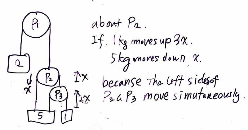

this is a pulley system,
each masses are moving with acceleration with a1,a2,a3..
question)
1) How can i calculate the ratio a1:a2:a3 ?
2) How can i calculate the T(tenstion)?

As drawn, the right side is going to jamb the pulley and then act as a single mass. Are you sure its drawn correctly?
I missed the condition " the mass 5kg does not spin'
Others, all correctly drawn.im sure...
Then wouldn't you treat this as 2kg vs 6kg?
I don't think so. Imagine P2 position as fixed. P3 can move up x while a2 moves down x and a3 moves up 2x.
you are right. if P3 is fixed, M3 moves up 2x, m2 moving down 1x, but P3 is also moving up, by 1x.the M2 is drawing with 2T tension. so net of M3 is 3x.the not fixed P3 makes this problem complicated.

So work in terms of relative accelerations. What equation can you write relating the acceleration of the 5kg relative to P2 to the acceleration of the 1kg relative to P2?
haruspex said:
You seem to have written 2x in one place and 3x in another. Which is it?
while 1kg, moves up 2x to p3, p3 moves up 1x, so 1kg will move 3x to p2.
whe
whe
Very good.
So, what equation does that give you for the accelerations?

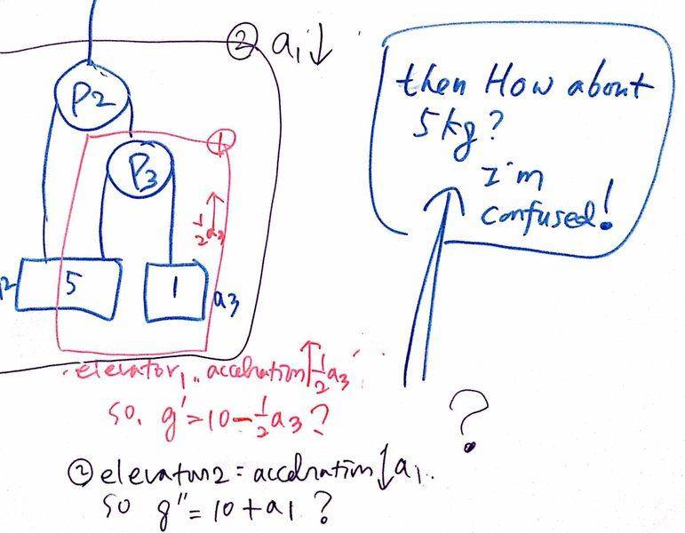

Don't worry about masses and forces yet, just think about the relationships that must apply to the accelerations because of the string lengths remaining constant.
In terms of a1, a2 and a3:
- what is the acceleration of P2?
- what is the acceleration of the 5kg mass relative to P2?
- what is the acceleration of the 1kg mass relative to P2?
- according to what you found in post #12, what equation connects those?

good morning sir,
i can calculate a1 a2 a3 to pulleys
but about equation of motion, I am very confused because of existence of 5kg.
5kg is connected to p3 and also tp p2.
T= 1*a3 + 1*g'---p3 equation
3T-5*a2=5g'
then, what?
i m not sure the motion equation to each pulley, p1,p2,p3.
