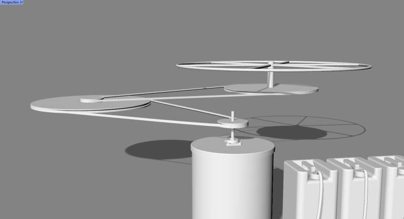

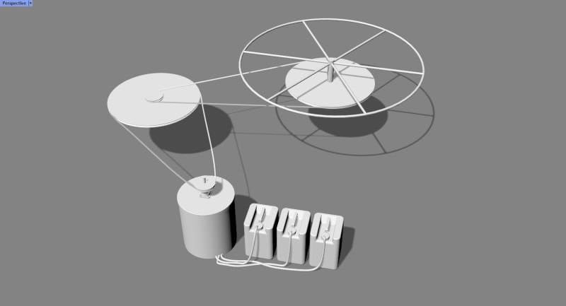

I am building a machine for a friend who works with cardboard pulp, he is also a performance artist and would like a machine where 2 or 3 performers can activate the machine by hand with pulleys and wheels, and shred the pieces of cardboard that are soaking in a container filled with water. There is 4 pulleys in total and the last driven pulley is attached to a shaft with blades on it, this whole assembly constitutes the shredding mechanism.
Currently the artist is shredding the cardboard with a hand drill on which is attached some very small DIY blades. The drill runs for about 30 minutes at 8000 RPM and he manages to get the consistency he wants.

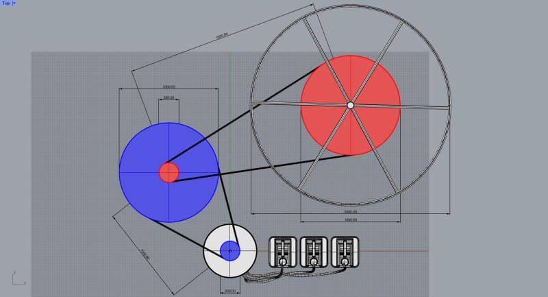

In my idea of his machine 2 performers would spin a horizontal wheel bar of 2 meter(6.56168 feet) diameter at about 5 to 15 RPM and that wheel bar is attached to a pulley which is driving a 1:5 pulley, that 1:5 pulley is attached to a 1:1 pulley which drives another 1:5 pulley. Since the blade that will be made for this machine is about 12 times bigger than the original blade he was using, I am not sure that we need as many RPM as the drill gives. But I am not very sure either. Anyhow, I thought that just a little less RPM than the drill would do the trick, maybe 5000 if that is even doable. All pulleys will be made of wood and the wheel bar will be in steel tubes.However it is my very first time working with pulleys and ratio and I lack experience in safety, in feasibility and in physics.
I do not know how to obtain the RPM I want for the rotating blade while having a decent of size for the whole machine. Here are a few links to some pictures that give you guys dimensions and other drawings to see the machine better.

Obviously the pulleys will not be floating, I just haven't thought about the structure yet, I wanted to have your opinion first.I am wondering if such a system will output the results I want, if it is durable and safe.

Are you sure about that 8000 RPM drill? How powerful is the drill? Because the fastest drill I have ever seen ran 2500 RPM. If the hand wheel turns 5 to 15 RPM, and you have two 5:1 drive ratios in series, the rotating blade will turn 125 to 375 RPM. A sketch or photo, with some dimensions, of the existing rotating blade would be helpful.
It will be as durable as you make it. It will be as safe as you make it. Human powered machines are easy to stop if something goes wrong, but you do need to design it so as to avoid pinch points.

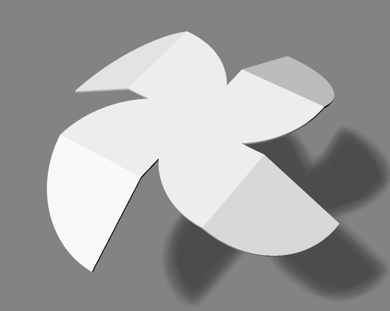

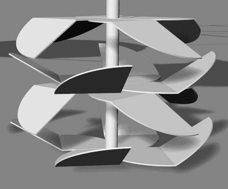

The blade is also something we will DIY, we'll take 8b200mm circular saw blades cut them in half and bend a quarter a few degrees. And then arrange them so that they look the same way I've attached in the pictures. There are some teeth on the curved part of the blade just as there are on wood circular saw blades.
The sketch I've already drawn is really a mock up, and even the gear system is something I tried to come up with but it is definitely okay to change it completely.

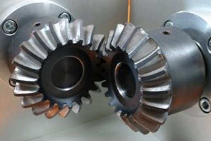

I've been advised earlier to think about pedal power, but I don't know how I could transmit the vertical spin of the sprocket into a horizontal spin for the shaft with available means.
Search bevel gears to find how to transmit power around a 90 degree corner. Lots of good hits on the first page of results.
