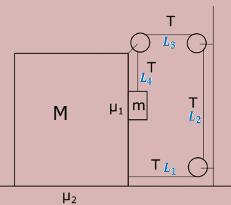

Question :- Find the acceleration of block of mass ##M##. The coefficient of friction between blocks is ##\mu_1## and between block and ground is ##\mu_2##.
free body diagram at the end.

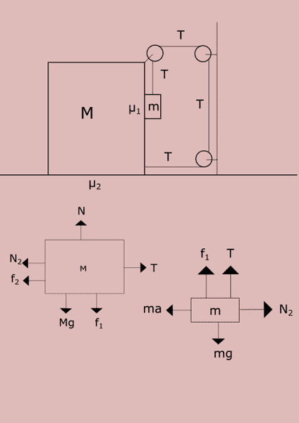

Variables :-
##f_1## - friction between blocks.
##f_2## - friction between block and ground.
##N_2## - Normal reaction between blocks.
##N_1## - Normal reaction between block and ground.
##T## - Tension in the string.
##a## - acceleration of the blocks since string is in-extendable.
##M < m##
Since small block will move down, and big one right.
$$ma = mg - (f_1 + T) \qquad (1)$$
$$T - (N_2 + f_2) = Ma \qquad (2)$$
$$N = Mg + f_1 \qquad (3)$$
If big block moves right then, pulleys will move right and small block will move right. Thus big block is non inertial frame. So we add the adequate pseudoforces to balance out unbalanced forces.
##N_2 = ma \qquad (4)##
##(1) + (2)##
$$a = mg - f_1 - N_2 - f_2 $$
$$a = mg - N_2 - ( f_2 + f_1 )$$
$$a = mg - N_2 - ( \mu_1 N_2 + N_1 \mu_2 )$$
substituting ##(3)## and ##(4)##
$$a(m + M) = mg - ma-(ma\mu_1 + \mu_2(Mg + f_1))$$
$$a(2m + M + \mu_1) = mg - \mu_2(Mg + ma\mu_1)$$
$$a(m(2 + \mu_1 + \mu_1 \mu_2) + M) = g(m - \mu_2 M)$$
$$a = {g(m - \mu_2 M)\over (m(2 + \mu_1 + \mu_1 \mu_2) + M)}$$
But the given answer is ##a = {[2m - \mu_2(M + m)]g\over M + m[5 + 2(\mu_1 + \mu_2)]}##.
I think the given solution is incorrect, because i can't find any error in my calculations but i am not sure.
Please check my free body diagrams in the picture below and my equations. I think any error in those would be sufficient for me to proceed ahead.

Is it correct to assume that the vertical acceleration of m equals the horizontal acceleration of M?

Did you mean those the other way around? It's a bit inconsistent with the other suffixes.

Their horizontal accelerations are the same, clearly, but what about the vertical acceleration of m?
TSny beat me to it.
I believe you are missing some of the tension forces T that act on the big block M.
I think vertical acceleration will also be ##a##.
Let total length of string be ##x## and displacement of smaller block be ##u## and bigger block be ##p## in some time ##t##.
So,
$$u + p = x$$
$${(du)^2\over dt^2} + {(dp)^2\over dt^2} = {(dx)^2\over dt^2}$$
$$\text{vertical acceleration of m} + \text{horizontal acceleration of M} = 0$$
$$\text{vertical acceleration of m} = -a$$
if we take magnitude, then ##\text{vertical acceleration of m} = a##
May you please point my mistake ?

Sorry for inconsistency. I wrote what i mean, did not mean it other way.

There are two horizontal strings that change length, but only one vertical.

I don't follow this. The string can be broken into four sections as shown
So should it be like this :-
$$L_1 + L_2 + L_3 + L_4 = x$$
$${d(L_1)\over dt^2} + {d(L_2)\over dt^2} + {d(L_3)\over dt^2} + {d(L_4)\over dt^2} = {d(x)\over dt^2} $$
$${d(L_1)\over dt^2} + 0 + 2{d(L_3)\over dt^2} = 0$$
$$\text{vertical acceleration of m} + 2\text{horizontal acceleration of M} = 0$$
$$\text{vertical acceleration of m} = |2\text{horizontal acceleration of M}| $$
$$\text{vertical acceleration of m} = |2a| $$
Yes, that looks good. (Your notation for second derivatives is a bit off.)
