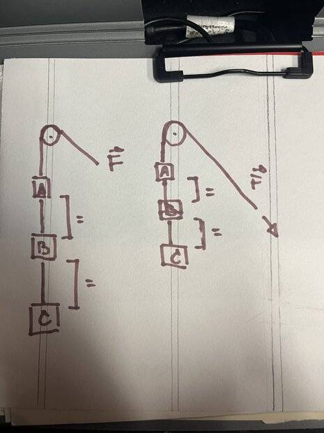

Dear readers,
I want to design a pulley system like in the schematic below, a system where the distance between certain attachment points are equally spaced along a vertical bar. The main feature of these pulleys is that when a force (F) is applied on one end of the cable, the attachment points (A, B, C) move upwards and the distance between them closes and stays the same between point A and B but also between B and C, much like the crossing joints of a scissor mechanism.
Any ideas?
Kind regards.

Welcome to PF.
So you want;
A to rise at a speed of 1.
B to rise at a speed of 2, and
C to rise at a speed of 3.
They will all reach the top at the same time.

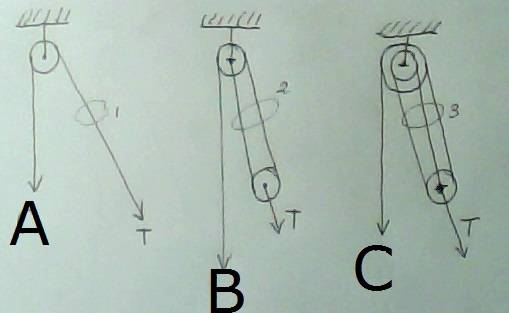

Besides the pulleys, what type of mechanism do you have in mind?
Can you provide a diagram of your general idea, please?
Here, the three systems are shown separated. There may be duplicated pulleys when all three are combined. Notice that the top pulleys are anchored, but the lower pulley blocks are moved by a distance of T.
The movement of length T, results in a movement determined by the number of falls to T.
1T for point A; 2T for point B; 3T for point C.
