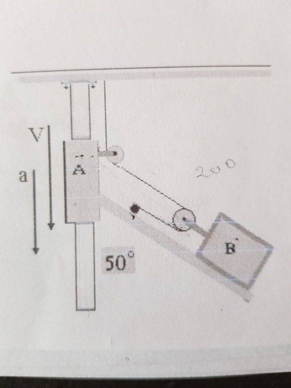

Suppose that at the instant depicted in the figure, ##A## has a velocity of ##-400 cm/s## and an acceleration of ##-16 cm/s^2##. The motion of ##A## and the motion of ##B## are related by the pulley and cord system. Determine ##\vec v_{B/A}, \vec a_{B/A}, \vec v_{B/Earth}, \vec a_{B/Earth}## and the normal acceleration of ##B## with respect to Earth.
##\vec V_{B/A} =\vec V_B - \vec V_A##
Well, first I tried to understand the relation between the velocities and accelerations of both bodies and I got that the velocity of ##B## is half the velocity of ##A##. This is because a change in length of the cord "that touches ##A##" must be equal to the change in length of the two cords that are touching ##B##. Correct me if I'm wrong please.
So, if ##V_A=-400 cm/s##, then ##V_B=-200 cm/s##. And these velocities are with respect to Earth?
Then, ##V_{B/A}=V_B -V_A##, so using the angle and the data from before I got ##V_{B/A}=200 cm/s##. Is it ok?
And finally, the normal acceleration of ##B## must be 0, because it moves in a straight line. Am I wrong?

Hello
Like Tony Stark said:
So, if VA=−400cm/s, then VB=−200cm/s. And these velocities are with respect to Earth?
The figure makes me image that if VA=−400cm/s in vertical direction then not VB but VB/A= 200cm/s sin( 50 degree )in horizontal direction and -200cm cos (50 degree) in vertical direction. If it's OK then ##\mathbf{V_B}=\mathbf{V_A}+\mathbf{V_{B/A}}## gives us velocity of B against Earth.
One of these is not relative to the earth. The length of "the cord that touches ##A##" is measured from A to a fixed point on the earth. The "two cords touching ##B##" are measured from ##B## to points fixed on ##A##.
I think the normal direction here refers to a direction perpendicular to the surface that ##B## moves on. They ask for the normal acceleration of ##B## relative to the earth, not relative to ##A##.
