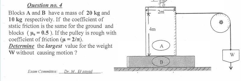

Pulley with friction, how to get the friction in the pulley?
In summary, the tension in the rope connected to the block A equals the static friction ##\sum{}^{} F_x =0 \rightarrow T=N_A*0.5=100N##, then the W weight or force equals to the tension in the pulley and the tension T ##W=100+\frac{2W}{\pi} \rightarrow W=275.2N##.
YehiaMedhat
Blocks A and B have a weights of 200N and 100N respectively. If the coefficient of static friction is the same for the ground and blocks ##\mu_s =0.5##. If the pulley is rough with coefficient of friction ##\mu =\frac{2}{\pi}##. Determine the the largest value of the weight W without causing motion.
##F_s=\mu_s*N##
##\sum{}^{} F_y =0##
##\sum{}^{} F_x =0##
First, I assumed that the tension in the rope connected to the block A equals the static friction ##\sum{}^{} F_x =0 \rightarrow T=N_A*0.5=100N##, then the W weight or force equals to the tension in the pulley and the tension T ##W=100+\frac{2W}{\pi} \rightarrow W=275.2N##
It's the first problem I have with friction in the pulley so was that correct? I feel uncomfortable with it.

I am unsure what the question means by "pulley friction".
If it means friction between rope and pulley we should ignore it. It is only axle friction that will matter.
If it means axle friction then we can think of the axle as a fixed cylinder with the pulley wheel as a rigid ring of slightly larger radius sliding around it. Ignoring the weight of the ring, where will the point of contact between ring and axle be? What will the normal force be there?
A third possibility is that they don’t mean pulley. Rather, it is just a fixed cylinder with the rope sliding over it. The normal force and tension vary around the curve. Are you familiar with capstan analysis? https://en.wikipedia.org/wiki/Capstan_equation. The given coefficient of friction seems crafted to suit this meaning.
You should also note that the question specifies no motion. That is not just no sliding.

But it's the 'numbers' that you want!!! To spell it out a bit...
The question says ‘without causing motion’. There are three ways 'motion' could start:
1. Block A tips (pivots about its bottom right corner).
2. Block A slips alone.
3. Blocks A and B slip together.
Your first task is to calculate the smallest force (tension in the horizontal part of the rope) for each of the above and decide which one is relevant.
Your second task is to find W. I think that using the capstan equation (as already mentioned by @haruspex) is expected.

Here's what I got:in the first case (Block A tips):##\sum{}^{} M_{right\ bottom\ corner} = 0 \rightarrow 200*1=4*T\ (tension\ in\ the\ rope\ connected\ to\ the\ block) \rightarrow T=50N##
The second case (block A slips alone): ##\sum{}^{} F_x =0 \rightarrow 0.5*200=T \rightarrow T= 100N ##
The third case (both blocks slip): ##\sum{}^{} F_x=0 \rightarrow T=0.5*N_A+0.5*(N_A+N_B) \rightarrow T= 250N##
The third case is the right one because the T is the largest, isn't it?

What is that thing shown on top of block A?
Wouldn’t that block tip over before sliding?
Why is pi in the value of the pulley’s coefficient of friction?

Some hinge from another problem
Ok, so that's my mistake it should tip first because the force required for making tip is much smaller
Something circlish, more precisely to let the angle which the rope is touching the pulley over fit in the capstan law well, as the coefficient is multiplied by the angle, Am I wrong?
Ok, the friction in the pulley is going to be (by capstan equation & assuming block_A will tip over): ##W=T*e^{\frac{2}{\pi}*\frac{\pi}{2}} \rightarrow W=50*e=135.91N##
Please, tell me this is correct :')

For information, that's wrong. If A an B slide together, A doesn't move relative to B. We must treat A and B as a single (30kg) object, ‘AB’.
In that case, the frictional force of A on B is exactly equal in magnitude and opposite in direction to the frictional force of B of A (Newton's 3rd Law). These two internal forces cancel so they do not affect the overall motion of AB.
P.S. What is 90º in radians?

As I noted in post #2, there are three possible interpretations of the given pulley friction.
  • Judging from the form of the coefficient quoted, they don't mean a pulley at all. Rather, it is just a capstan.
  • If it is for static friction between pulley and rope, the axle being frictionless, we can ignore it.
  • If it means axle friction we need a model for how the pulley's annulus contacts its axle. I would opt for a normal force at ##\pi/4## to the vertical.
I see no interpretation in which the tension is unaffected by static friction and yet, if motion of the block occurs, the friction would consume work.

The text of the problem states “the pulley is rough”.
The diagram shows some hatching along the perimeter of rope contact (as well as around the axle).
I understand that as the second case you have listed, which makes the value of in and out tensions alike.
But then, the same text gives a value of μ that includes π - why?

It seems very likely that the question is simply badly written: ‘pulley’ should be ‘fixed pulley-wheel’ or ‘capstan’.
If you are not familiar with the ‘capstan equation’, it applies to a rope wrapped around a capstan (fixed cylinder). If the subtended angle of contact is ##θ##, then the equation relates the ‘load tension’ and the ‘hold tension': ##T_{load} = T_{hold} ~e^{μθ}##.
In this question ##μ = 2/π## and ##θ = π/2## look like deliberate choices to facilitate use of the equation.
