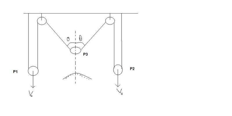

In the given arrangement pulley P1 and P2 are moving with constant speed vo downward and the centre of the pulley P lies on the principal axis of a convex mirror having radius of curvature R. Find the speed of image of pulley P when it is at a distance x from the surface of convex mirror in terms of vo, R, x and θ
This question is pretty easy but I got stuck at one point.
Using constraint relations,
I got 2vo - vcosθ + (L-xp)sinθ =0
where v is the velocity of Pulley P and L is the distance of the mirror from the upper fixed support.
i.e. v= (2vo + (L-xp)sinθ)/cosθ
This is not the final answer but as per the solution given v = 2vo/cosθ (which is written directly)
Can somebody explain me my mistake?
Thanks
Hi Abdul! :smile:
Abdul Quadeer said:
I got 2vo - vcosθ + (L-x)sinθ =0
I don't understand where (L-x)sinθ came from. :confused:
What is your constraint equation for the lengths (not speeds) of the vertical and diagonal bits of string? :wink:
Hi tiny-tim! :smile:
This is my equation in terms of length of the string-
2xp1 + 2xpcosΦ + 2xp2 = Total length of the string,
where Φ = angle at any instant
Now if we consider the change in lengths and differentiate w.r.t time,
The equation reduces to
vp1 - vpcosΦ + xpsinΦ + vp2 = 0
On substituting the values given in the question,
2vo - vcosθ + xpsinθ = 0
I considered all distances from the fixed support. Let the distance of the mirror from the fixed support be L. So distance of the pulley P from the mirror is L - xp (sorry I missed s.s. 'p' earlier).
The above equation reduces to
2vo - vcosθ + (L-xp)sinθ = 0
It'll be easier if you use the fact that the horizontal distance is constant. :smile:
(btw, x1 etc is a lot clearer and easier to write than xp1 :wink:)
Where shall I use that fact?
Here in xpcosΦ both xp and cosΦ are variables.
That fact would have been useful if
was differentiated again so that xpsinθ vanishes
x0/H = … ? :smile:
what is xo and H ? :confused:
uhh? :confused:
dx0/dt = v0, and what do you think H is? :rolleyes:
I am getting confused :rolleyes:
H might be the distance of the mirror from the support ( I used L for it ).
I still don't understand how xo/H will help :|
Abdul, in the original diagram, L and xp1 were not marked, and you had to write them in.
Sometimes questions are like that.
They don't always spoon-feed you with the information you require.
You need to look at the diagram, find something else you haven't used yet, call it H, and use it.
