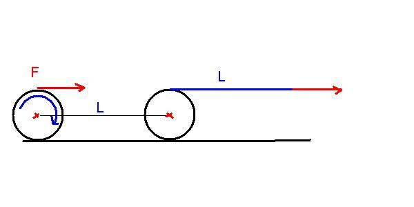

A massless rope is wrapped several times around a solid cylinder of radius R = 20 cm and
mass M = 20 kg, which is at rest on a horizontal surface.
Someone pulls 1 m of the rope with a constant force of 100 N, setting the cylinder in motion.
Assuming that the rope neither stretches nor slips and that the cylinder rolls without slipping,
what is the final angular velocity of the cylinder and the speed at its surface?
The moment of inertia of a cylinder of mass M and radius R is MR2/2.
work=force*distance=Fx
KE_trans=0.5*m*v^2
KE_rot=0.5*I*w^2
I've used conservation of energy to write that Fx=0.5*m*w^2*R^2+0.5*0.5*m*R^2*w^2=0.75*m*R^2*w^2.
Obviously I'd rearrange this for w, but I don't know how to find x. The question says that 1m of rope is pulled off the cylinder, but how do I find the distance that the cylinder travels in this time? I realize this is probably obvious

Oh, boy, now I see: pulling 1 m of rope with 100 N does not mean doing 100 J of work for you ?
That what you are referring to when you say you don't know how to find x ?
The rope is horizontal, 20 cm above the surface and the cylinder rolls towards the someone!
I tried that, it gives the wrong answer. The problem is that when pulling 1m of rope, the cylinder will turn through a distance > 1m and this distance is what I call x
Correct answer is 18.4 rad/s btw.
You can do some little experiment...
If you pull off L length of rope from the cylinder (of radius R) it turns θ=L/R angle. The cylinder rolls without slipping. It means that the centre moves with speed Rω, and the distance traveled by the centre is θR.
The work is force times the distance traveled by the point of application. The force is applied at the end of the rope. The cylinder travels θR distance when length L is pulled off. How far is the end of the rope from the initial position?
2 metres?
RightFresh said:
2 metres?
Yes!

I did not notice your post when I submitted my one. Everything happened so fast :) And you wrote that the work had to be 200 J ...
But an experiment (a real one) is always useful. I have a roll of paper for such rolling problems. :)
