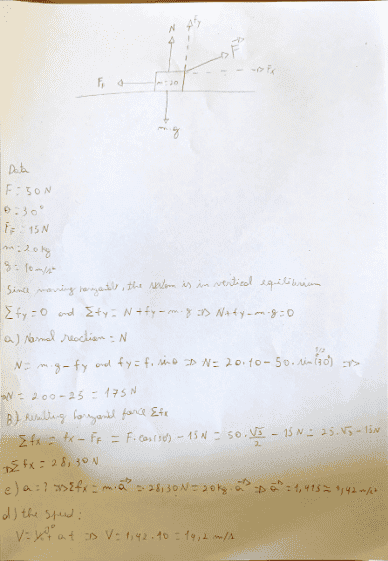

A man pulls a small sledge with a force F ⃗ of intensity equal to 50.0 N and that makes an angle with the horizontal θ = 30º (see figure). The sled moves horizontally and the resistance that the snow offers to the movement of the sled results in a frictional force of intensity F a = 15 N. the sled has a mass of 20 kg. Determine:
a) the normal reaction to which the sled is subjected;
b) the resulting horizontal force on the sled;
c) the acceleration acquired by the sled;
d) the speed acquired by the sled after 10 s, assuming it started from rest.
(Use g = 10.0 m ∙ s -2 ).

With this type of problem, it is usually best to start by drawing a Free Body Diagram (FBD). So show us your FBD for the sled, and show us the equations that you write for it given the problem description and the questions...

Thank You all for the answers and advice I used them to learn about the topic and solve the problem,
heres my answer:

Purpleshinyrock said:
heres my answer:
Illegible
phinds said:
Illegible
Is this better sir/maam?
Likes phinds
It looks right. But, did you know that ##14m/s## is about ##50km/h##? That's pretty fast for running backwards on snow.
