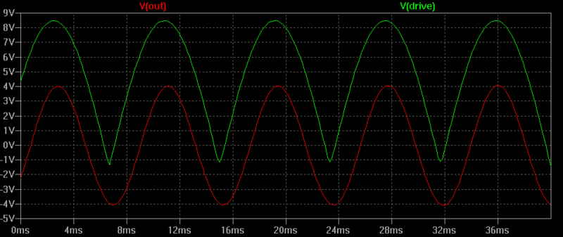

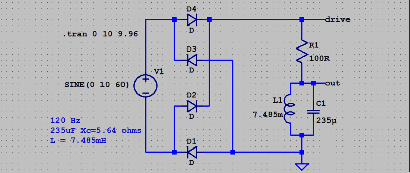

Here is a simulation with slightly different values for L and for C.
Notice the slight phase shift between drive and LC voltage due to not being accurately tuned.
