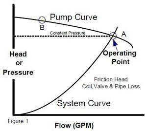

For a pump and nozzle set up like this, the pump and nozzle have to be sized to complement each other. Using just any pump isn't going to work, you need the system to operate under a specific set of conditions known as the "operating point". You gave 3 different flows for your nozzle in the OP. Note that as inlet pressure is increased, the amount of flow through the nozzle also increases. This increase in flow with an increase in pressure continues as pressure is increased, so at 100 psi, you might get 0.85 L/min out of the nozzle and at 200 psi, you might get 1.2 L/min out of the nozzle. To get 2.0 L/min out of the nozzle, you might need 550 psi.
Most engineers would draw a curve on a graph with flow on the X axis and pressure on the Y axis. The point at which that curve meets the flow of the pump is called the operating point as given for example, here:
http://www.engineeringtoolbox.com/pump-system-curves-d_635.html
Here's a graph that might be a bit more helpful:
In this graph, there's the "System Curve" which starts at 0,0 and rises up to the operating point. There's another curve called the "Pump Curve" which starts out high on the Y axis and drops down to cross the System Curve. Where they cross is the point that the system will naturally operate at. That point has a flow and a pressure. So what you need is to find a pump that flows roughly what you want the nozzle to flow at the inlet pressure your nozzle needs to produce that flow.
